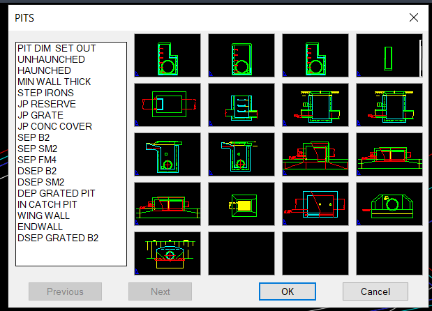

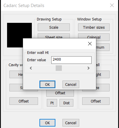

This can be done with autolisp and dcl. Is that what you are using or want to use?
I believe so, unless you have a better suggestion
I should have an example. Give me a bit, or someone else may chime in with something.
Great.  Thanks for the help and pointing me in the right direction
The other alternative is you can have child dcl ie a new dcl pops up over the top of the existing one. If you want to go that way can post some details on how to do, I know which code buts its full of multiple stuff will cut the relevant bits out.

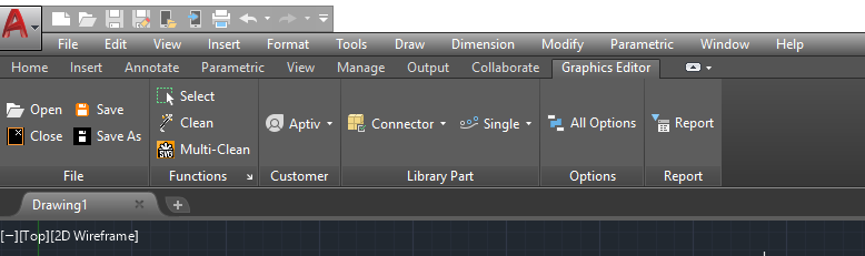

Sure.  I am given this task
Sorry I am so vague.
I have a ribbon panel with two buttons  (connector and single)
if you select the connector button and then select Annotation
Then click the subtype button  (Single or Multi)
I need "multiple" to be grayed out and not selectable in this case.
Is there a way to do this?
