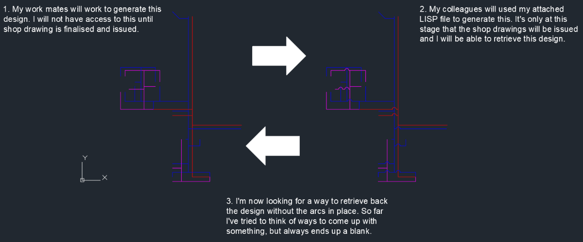

Hi fellow coders,
This is the biggest request that I will be making in this forum to this date. I don't really expect any solutions or codes, any ideas are also welcomed and I can try to do them once I've heard your opinions.

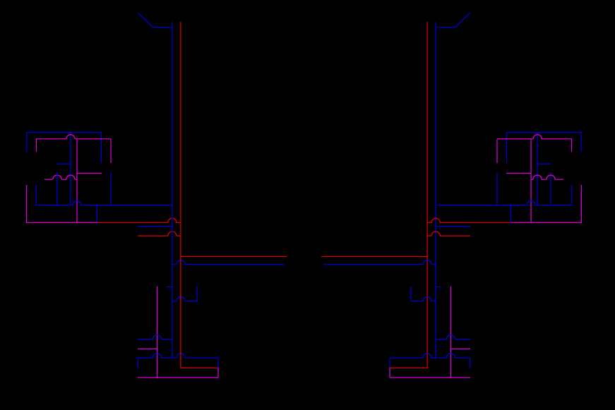

Here's the story: There are some lines drawn (as shown on the left) which represent pex connecting to different fixtures in an apartment. My colleagues will design this, and then produce the drawings on the right (using the attached LISP code that I created and provide them). I can never have access to the design on the left unless my colleagues issue the final drawing up for construction so that I can start detailing. Therefore I will always get the drawings on the right. Now I'm trying to find the easiest and quickest way to reverse this process, but to no luck. I welcome some ideas you might have (except asking my colleague not to do this). [Now the LISP routine might not be perfect because it does produce unexpected results when done on polylines near the vertices, but I highly doubt this will ever be the case. If there are polylines, there will never be any arc segments on it.]
This is the worst case scenario, but I don't think it will ever get to this point.

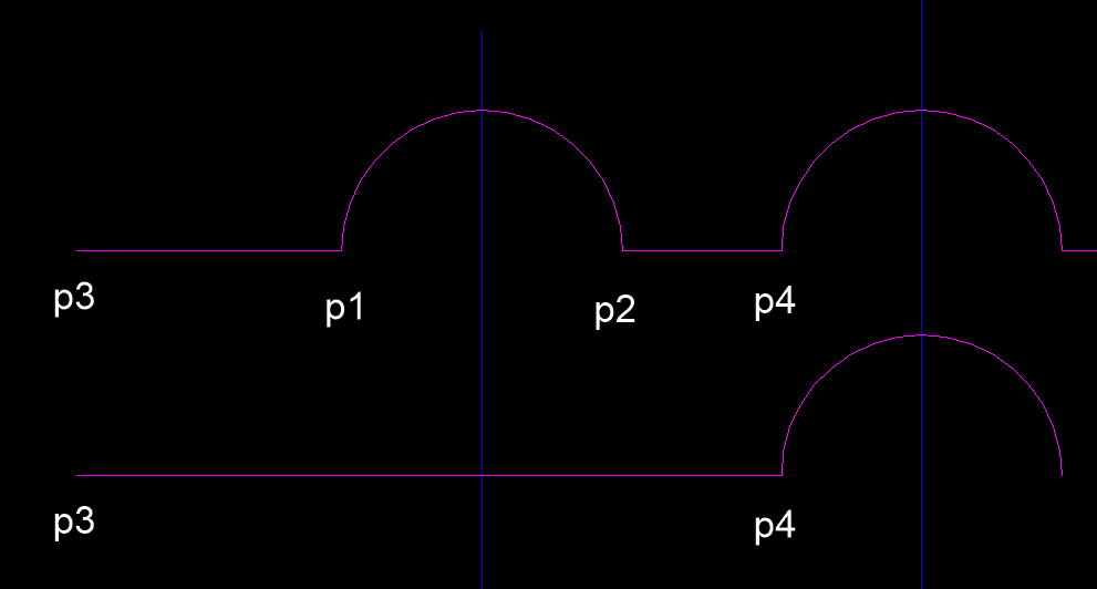

As there arcs you know start end points do a little sq aroud the point use ssget "CP" it will find the two objects connected in dwg they are a line ok ake a new line pt1 pt2 etc then pedit entlast join ent1 ent2. This will give a 3 segment pline.
Version 2 ok again a little sq around end pts find 2 lines do a check and work out extreme away points p3 p4 erase 2 lines and arc draw a new line  p3 -p4

Theres a routine on internet to join collinear lines which was done by Lee Mac. Would serve a good purpose here.
Here is my attempt (which simply erases the ARC entites, creates lines and implements his 'Join colinear lines' by layer):

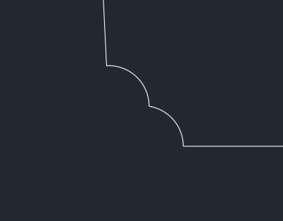

Although it won't deal with your worst case scenario, I think its possible to do it via Lee's Chain Selection algorithm, to determine the 'vectors' of the touching lines with arcs and calculate the potential intersection (when they are not collinear).
I might sound like a math guy here, but trust me I'm not. :lol:

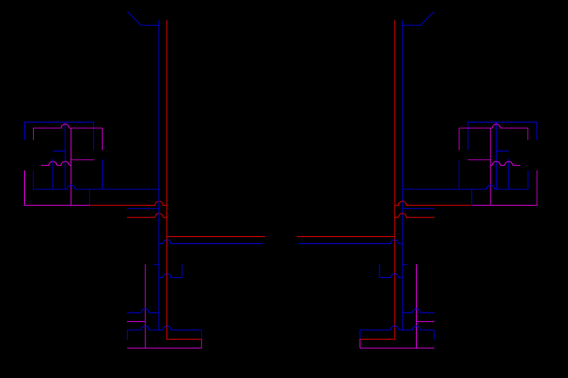

@Grrr Thanks for the idea. It certainly makes sense. I had an idea somewhere along the lines of how you did your codes too, but then you'll have to check on discontinuity of the lines too. Supposedly you copy the design on the right and place it somewhere on the right horizontally like so (or mirrored): (and surprisingly vertically as well).
Even though the lines from the separate design are not connected, they are still collinear. And even if it's not a separate design in another room, it could be one design in the same room where two unconnected collinear lines could exist.
@BIGAL The closest I've gotten was your idea. I don't think this will happen, but your idea would fail if some other existing lines touches the arcs like this. Since it's a shop drawing, there's way more elements in it than just a few simple lines. Then ssget will return multiple curves, and you won't know which curve to retrieve. (Well, I mean my LISP routine does match the properties of the arc to the curve, so I guess I can put some filters into the ssget to make it more robust, so your idea would be worth a shot.):
I appreciate your opinions guys! Thanks!

3 arcs interesting again though the ssget CP using a small box will find the next arc so is it arc or line ? If so look again for next arc and repeat is arc or line. Will play later today it would be a automated thing do all will start with 1 arc. Then think about 2 or more.
