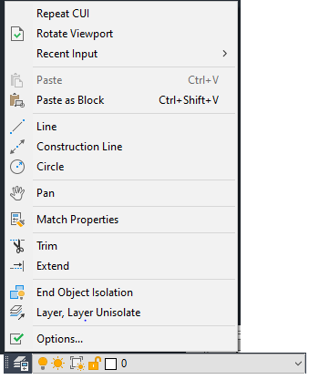

Is it possible to add the Layer Control command to the right click menu (see attachment).
Normally I add command from CUI, Shortcut menus, Edit Menu or Default Menu.
No that would not be possible. Why would you want it there anyway?

OK thanks.
I tried to add to the Quick Access Toolbar but it didn't let me, this is using the CUI. I can't drag the control.
Under Command List click the drop-down 'All Commands and Controls' and select 'Ribbon Control Elements' and search for Layer. It started out with a different name as I remember but is currently called the 'Layer List Combo Box'.

Thanks for confirming, now I know the correct name "Layer List Combo Box".

'Ribbon Control Elements' can only be used in the Ribbon and the QAT, they cannot even be used in a Toolbar. As Shortcut Menu items aren't static but picked to execute a task I wouldn't think even a drop-down scroller like the old Toolbar layer selector would work as a Shortcut item.
