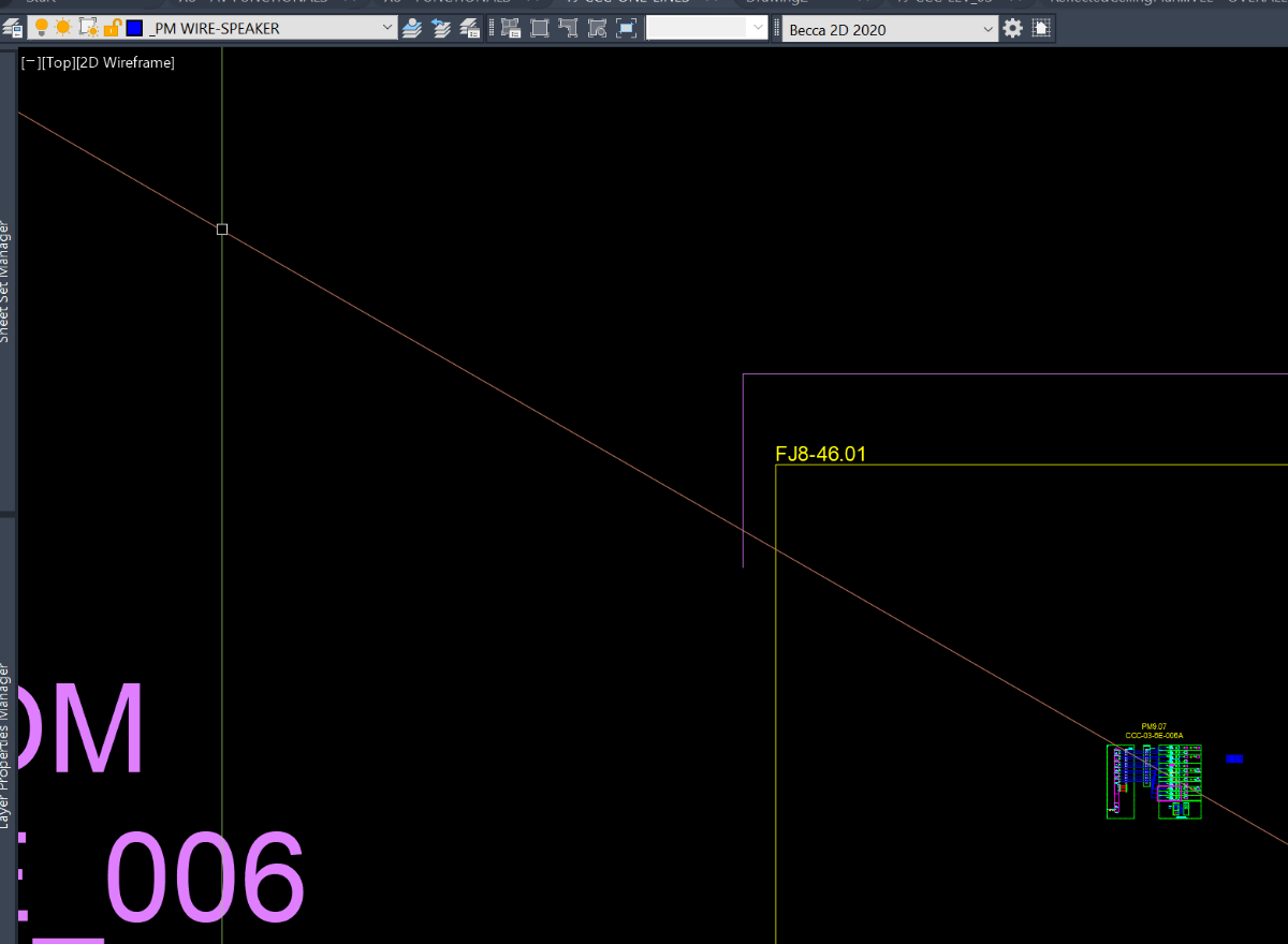

Help. I have one file where the crosshairs look like this. I have NO IDEA WHY. It's driving me nuts. It's a 2D file, in top view, there's nothing special happening here. The file is too large to attach, and I can't really copy everything to a new file to test. This is one we've gotten from a client and have to work in, and it's TERRIBLE!
Yup... I found it like RIGHT after I asked this question. That's not a setting I normally use. Whoops <facepalm>

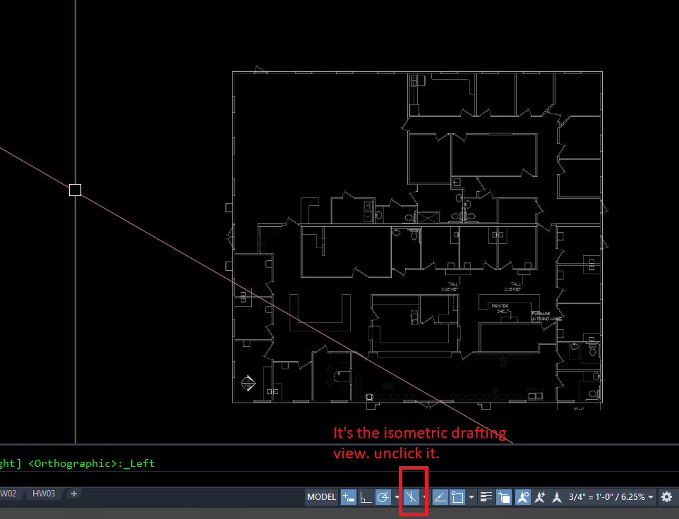

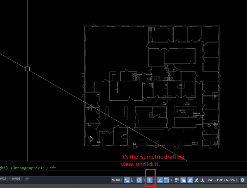

FYI, for anyone else that may come across this issue and doesn't have the icon in their tray...ISODRAFT will also solve it.
They can also click the three horizontal bars at the far right of the task bar to select the icon (toggle) desired to show. 👍

Yup... I just like to LEAVE those icons hidden so I don't accidentally turn them on. Cause whoops.
