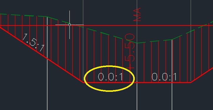

Help Select all Text Object with Content and delete it automatically
need to modified to delete text object with specific content and automatically delete  it
this code i get somewhere,  i have to mannually enter the text and press dell, can someone help me ?

you could replace (sssetfirst nil ss) with (entdel (ssname ss 0)) but in your picture I see same text twice so how whould routine know which one should be deleted? Unless you want to delete all text with this text.

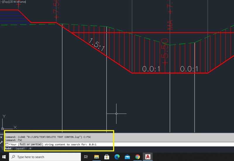

I HAVE manage select all those text with current command and enter the text content then press delete, what i want is when i type FSC it select all texts automatically without typing it and press del

Maybe what he meant and didn't explain was something like this.
;;; Delete all the texts with the string "0.0:"
(defun c:fsc (/ i str ss)
   (if (setq ss (ssget "_X" (list (cons 0 "*TEXT") (cons 1 (strcat "*" "0.0:" "*"))
 (cons 410 (getvar 'ctab)))))
         (setq i -1)
         (repeat (sslength ss)
            (entdel (ssname ss (setq i (1+ i))))
  • Thanks 1
