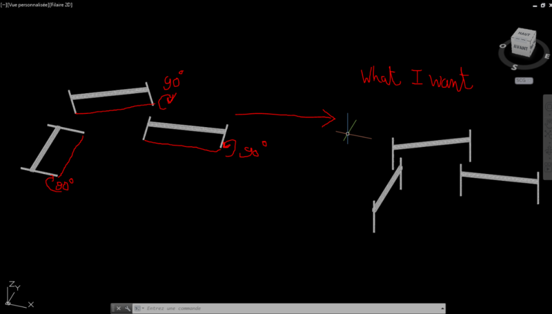

dr.hybride Posted April 29, 2021 Author Share Posted April 29, 2021 Very good job @lrm thank you very much a last thing, is it possible to do the same thing for several block at one time ? have good day Quote Link to comment Share on other sites More sharing options...
lrm Posted April 29, 2021 Share Posted April 29, 2021 @dr.hybride you are welcome. The following program should work on multiple blocks. I stole some code from @rlx for going through a selection list and replaced the nentsel function with nentselp which interestingly transposes the matrix that nentsel uses. The following functions should work but may have a problem if two objects have the same insertion point. (defun c:rot90x (/ sel idx lst obj m xdir basept blk refpt) ; rotates a blocks by 90° about their x axis. ; lrm 4/29/2021 (setq osm (getvar "osmode")) (setvar "osmode" 0) (setq sel (ssget "_:L" '((0 . "INSERT")))) (repeat (setq idx (sslength sel)) (setq lst (cons (cons (setq obj (vlax-ename->vla-object (ssname sel (setq idx (1- idx)))) ) (vlax-get obj 'insertionpoint) ) lst ) ) (setq basept (list (nth 1 (nth 0 lst)) (nth 2 (nth 0 lst)) (nth 3 (nth 0 lst)) ) ) (setq blk (cdr (nentselp basept))) (setq m (nth 1 blk)) (setq xdir (list (car (car m)) (car (cadr m)) (car (caddr m))) refpt (mapcar '+ basept xdir) ) (command "_rotate3d" basept "" "2" basept refpt 90.0) ) (setvar "osmode" osm) (princ) ) (defun c:rot90ang (/ sel idx lst obj m xdir basept blk refpt) ; rotates blocks by 90° about their x axis projected to the WCS xy plane. (setq osm (getvar "osmode")) (setvar "osmode" 0) (setq sel (ssget "_:L" '((0 . "INSERT")))) (repeat (setq idx (sslength sel)) (setq lst (cons (cons (setq obj (vlax-ename->vla-object (ssname sel (setq idx (1- idx)))) ) (vlax-get obj 'insertionpoint) ) lst ) ) (setq basept (list (nth 1 (nth 0 lst)) (nth 2 (nth 0 lst)) (nth 3 (nth 0 lst)) ) ) (setq blk (cdr (nentselp basept))) (setq m (nth 1 blk)) (setq xdir (list (car (car m)) (car (cadr m)) (car (caddr m))) refpt (mapcar '+ basept xdir) refpt (list (nth 0 refpt) (nth 1 refpt) (nth 2 basept)) ) (command "_rotate3d" basept "" "2" basept refpt 90.0) ) (setvar "osmode" osm) (princ) ) rotate multiple blocks in 3D.lsp Quote Link to comment Share on other sites More sharing options...
SEANT Posted April 29, 2021 Share Posted April 29, 2021 For what it's worth, here is one way it could be done with VBA: Option Explicit Public Sub StandUp() Dim entSelected As AcadEntity Dim vPt As Variant Dim dblRotAng As Double Dim blkRef As AcadBlockReference Dim varInsPt As Variant Dim dblNewNorm(0 To 2) As Double Dim varNewInsPt As Variant Dim intCode(0) As Integer Dim varData(0) As Variant With ThisDrawing intCode(0) = 0: varData(0) = "INSERT" If SoSSS(intCode, varData) > 0 Then For Each entSelected In .SelectionSets.Item("TempSSet") Set blkRef = entSelected If blkRef.EffectiveName = "Fence" Then varInsPt = blkRef.InsertionPoint dblRotAng = blkRef.Rotation dblNewNorm(0) = Sin(dblRotAng): dblNewNorm(1) = -Cos(dblRotAng): dblNewNorm(2) = 0 blkRef.Rotation = 0# blkRef.Normal = dblNewNorm varNewInsPt = .Utility.TranslateCoordinates(varInsPt, acWorld, acOCS, 0, dblNewNorm) varNewInsPt = .Utility.TranslateCoordinates(varNewInsPt, acOCS, acWorld, 0, dblNewNorm) blkRef.InsertionPoint = varNewInsPt End If Next End If End With End Sub Private Sub SSClear() Dim SSS As AcadSelectionSets On Error Resume Next Set SSS = ThisDrawing.SelectionSets If SSS.Count > 0 Then SSS.Item("TempSSet").Delete End If End Sub Function SoSSS(Optional grpCode As Variant, Optional dataVal As Variant) As Integer Dim TempObjSS As AcadSelectionSet SSClear Set TempObjSS = ThisDrawing.SelectionSets.Add("TempSSet") 'pick selection set If IsMissing(grpCode) Then TempObjSS.SelectOnScreen Else TempObjSS.SelectOnScreen grpCode, dataVal End If SoSSS = TempObjSS.Count End Function Quote Link to comment Share on other sites More sharing options...
