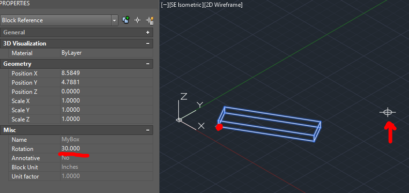

I found that but I want to change the second point which will be defined with the angle, one meter from the first point.
If you are working in 3D you will need to specify two angles to define the location of the second point. For example, an angle in the XY plane and an angle about the z axis. The distance is not important as the two points are defining an axis of rotation and it doesn't matter how far apart they are.  It's not clear what you are trying to do.  Your first post indicated that you want to rotate a block in 3D space but your last post seems to imply that you really just want to rotate in a plane.

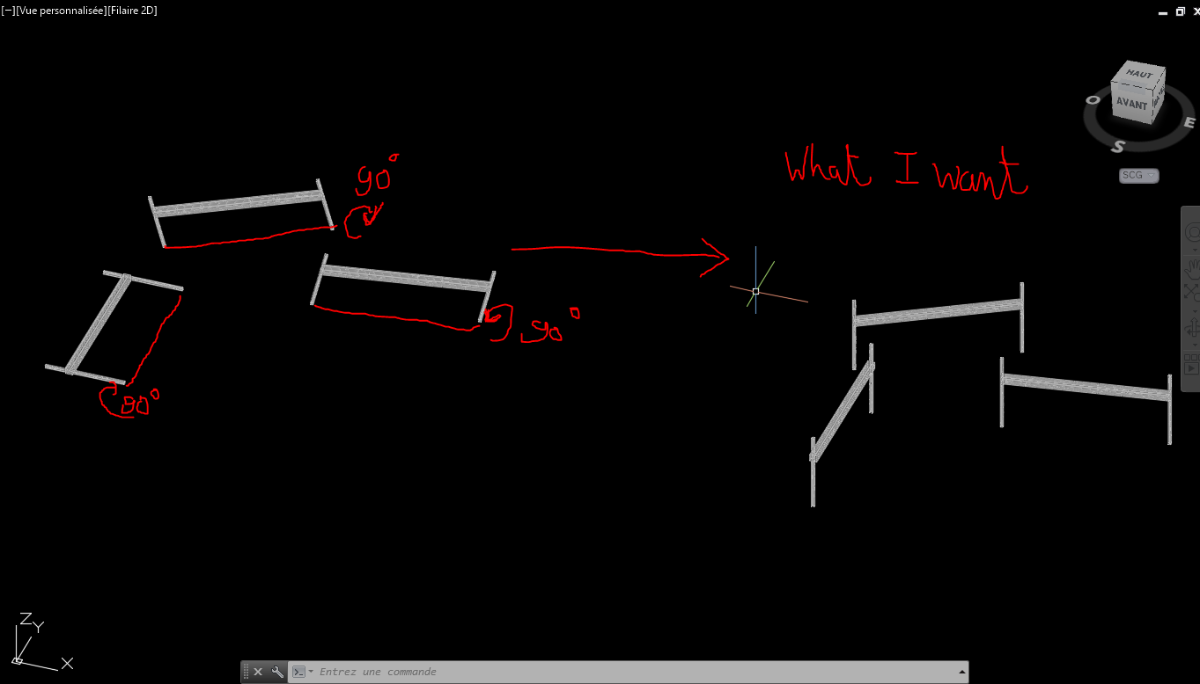

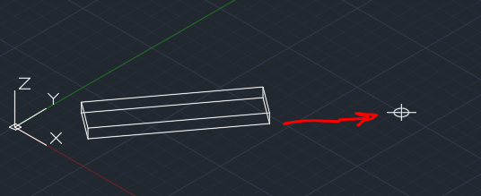

Sorry i was not clear, i agree with you, i know that to rotate ( 3Drotate and not rotate 3d ) you need to select two points and define an angle, but the thing is i have a lot of block so i dont want to select for each block two points. the idea is that i wanted to use formula trigonometry ( cosinus angle something like this) to select automatically the second point.
see the picture
It is still not clear to me what is your goal.  Perhaps someone else would like to jump in and help.
Could you clarify the following?
1.  Do you want a vlisp program that will allow you to select many blocks at one time and have them all rotate to some specified orientation or do you want to work on a single block?
2. Do you realize that the angle specified in the Properties panel is the angle of rotation in the WCS and does not reflect the current UCS nor the fact the the block may be rotated out of the WCS XY plane?
3. If you want to rotate an object so that it is oriented from a base point to a reference point you can use the Reference option with the rotate command.  For example,  the block MyBox is oriented at an angle of 30°.  Let's say we would like the long side of the box to point from the base point to the point at right.
Give the rotate command, select the block and then the base point.
Now input R (reference)  and specify the base point (1)  and a second point (2) for the reference direction and a point for the new direction (3).
The result is the following.
Is this what you want to do?

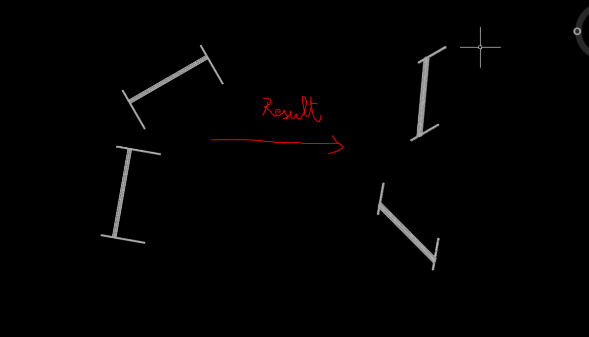

thank you for your help lrm
yes i want to select many block at one time and rotate at 90°
The following command rot90x,  will rotate a block by 90° about its x axis but will only do one at a time.  Perhaps someone else can enhance it for multiple blocks or has another approach.

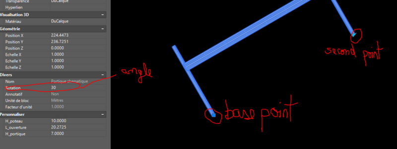

Hello evryone thank you all
but it does not work. i tested and see the result in the picture

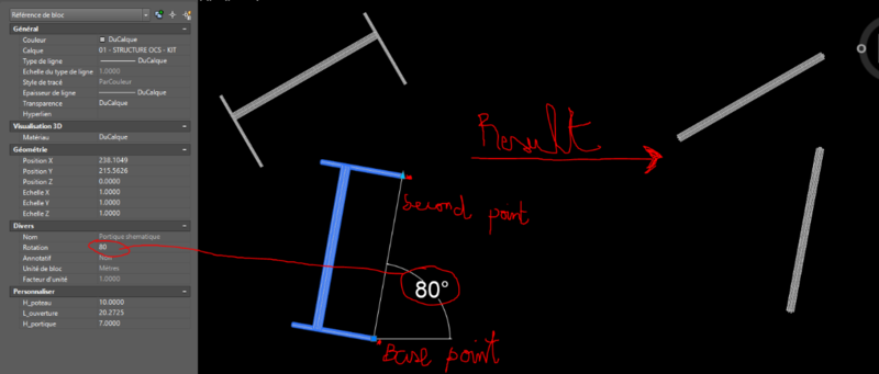

@rlx  The program 3drblk appears to rotate the blocks about an axis parallel to the world x, y, or z axis.  I think the OP wants the blocks to rotated about the block's local axis but he hasn't made that clear.  He may in fact may want to define a local axis with 2 points.  Having a copy of the block would help  to understand the requirements.
@lrm , you maybe right , only tested it on a flog of flat-world symbols because I have no 3D symbols. They all fell over at the x-axis so was kinda hoping this is it... awell it was worth a shot. Just not experiece with 3D I'm afraid 🙄

hello everyone thank you all
i'm more confortable in VBA, this why i did in VBA , if someone can to translate in lisp.

It looks like your VBA code rotates the block by 90° about an axis defined by a line from the basepoint  to a point define by the the angle of the block.  As noted earlier, the angle parameter is the angle defined by the projection of the x-axis of the block onto the xy plane.
Here are two versions of a vlisp program to rotate a block by 90° about an axis define by two points.
rot90x rotates a block by 90° about the x axis of the block.
rot90ang rotates a block by 90° about the line define by the x axis of the block projected to the XY plane.  This should be similar to your VBA program.
