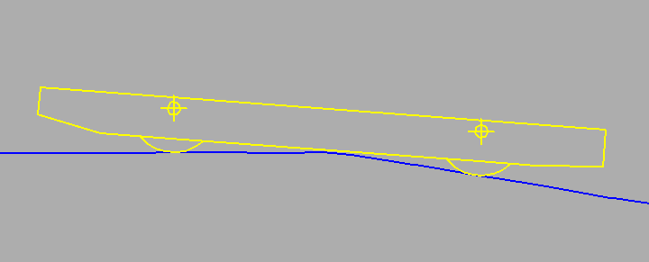

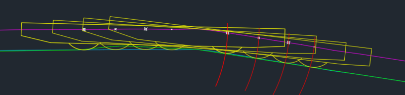

Hi,
I've found the align object lisp from Lee Mac (thank you sir).
I have a slope for an underground garage where a special type of car can't pass the entrance (hanging too low).
They have given me a model of the car.
I want to align the car to the curve i've created.
The problem is that the car has two tires, represented by circles.
The point where they hit the curve is somewhere along those circles and i should align with 2 points to the curve.
Can you help me out?
The blue line is a section i've taken from the DTM,
The green line is a proposition i've made with trial and error.
car align to curve.dwgFetching info...
Edited by B.N.
to add a picture
You want to do this to see if your curve will work? why not just use 3 point circle command and use tangent points of the two circles and the underside of the car. that will give you the absolute maximum radius you can use.

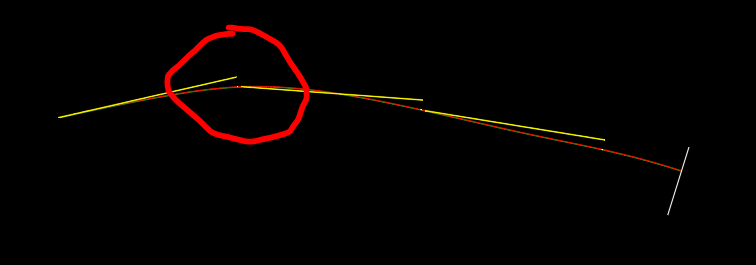

Your proposed profile does look a bit odd, going up and down. Surely the most efficient profile to get from one gradient to another is a circular curve.
I am not sure how a lisp programme would be of any use in this instance. Get the two gradients from the DTM and fillet between them with the radius given above (surely minimum radius, not maximum).
I see the ground clearance is 0.11 m. What happens if a driver of different weight gets in? Perhaps increase the ground profile radius to 10m.

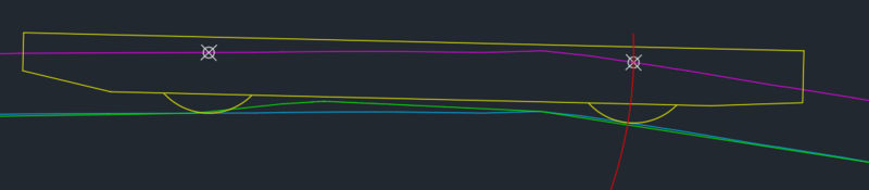

Are you looking for something like this?
           Block AUTO-1
           MEASURE...
Regards
Jochen
www.black-cad.de
Expand
Something like that indeed! If I check your file there are some wheels below the curve. Why’s that? Thanks

the odd design is because it is applied on an alignment view coming from a dtm.
There is a suggested margin of 4cm to cover the difference in load.
there is already a road placed so they want minimum demolition and a smooth curve up till the profile at the entrance (point where the section goes down)

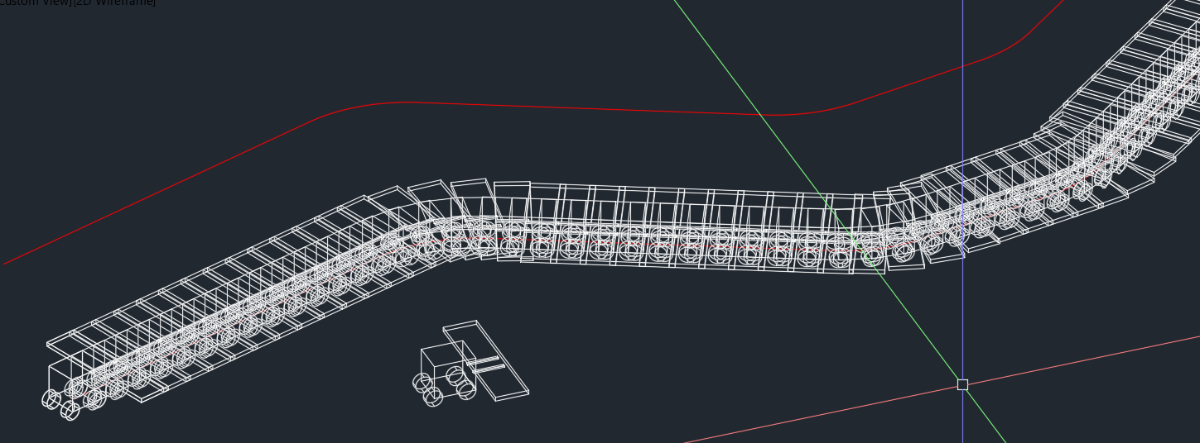

@B.N. You want something like this?

Could be done like this too .. not sure which is more 'correct' for your use.

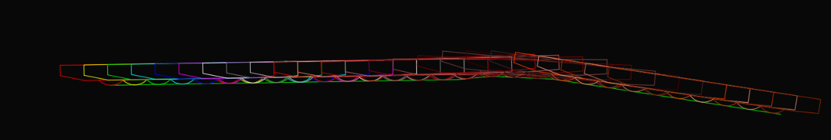

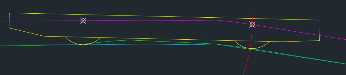

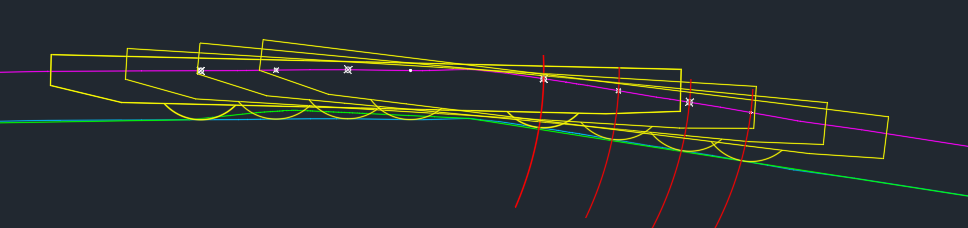

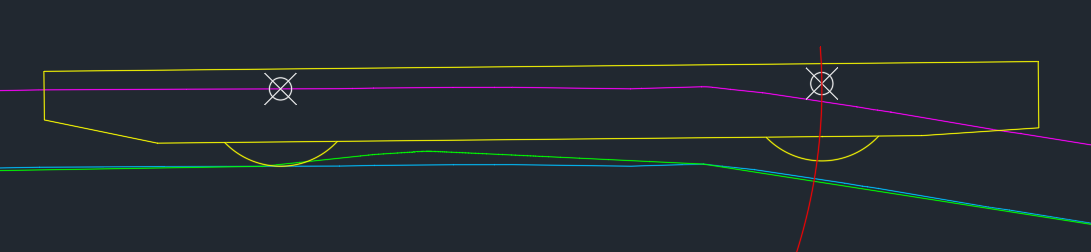

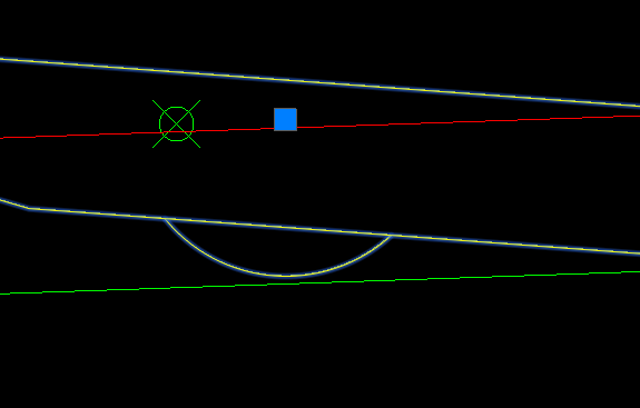

No need for trial and error.  Add points to the car (block) at the center of the tires and create an arc with a radius of the wheel base centered on the rear wheel (I assume the rear is to the left).
Construct an offset line to the surface profile at a distance equal to the radius of the tires (0.35 in your drawing).  Position the center of the rear (left?) tire on the offset line as shown here using osnap nearest.
Set osnap to endpoint, node, intersection and ow give the rotate command and click the center of the rear tire for the Base Point and then enter R and click the center of the rear wheel again and then the center of the front wheel and then click at the intersection of the red arc and the magenta offset line.
This will precisely position the car.
If you do not need precise rotation you can eyeball it!

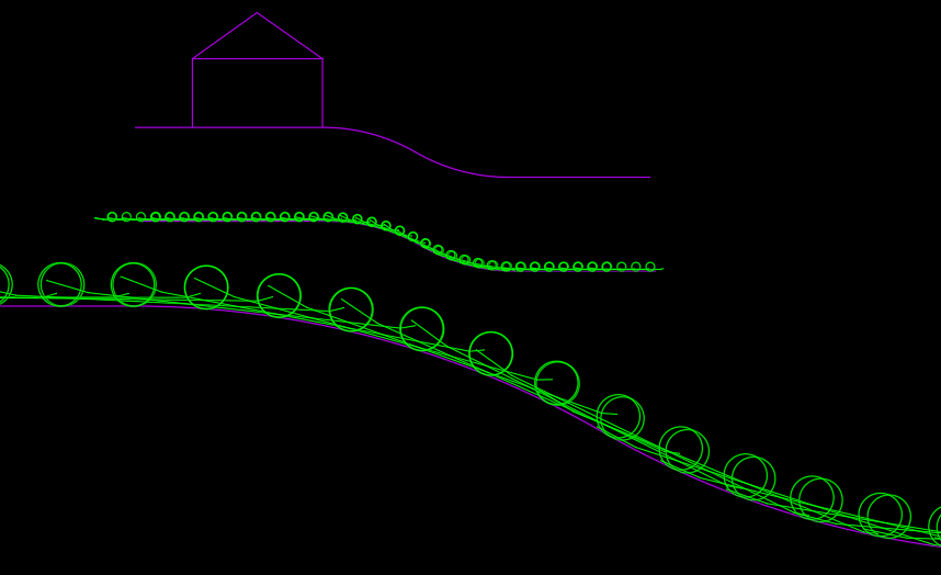

Here's the result of 4 positionings.
image.thumb.png.d4939ce4f833b9c49113b40d275861fa.png car align to curve.01.dwgFetching info...
  • Like 2
Thanks! solved my problem perfectly!!!
I've been helped to create the best curve and to place and align the car along that designed curve!

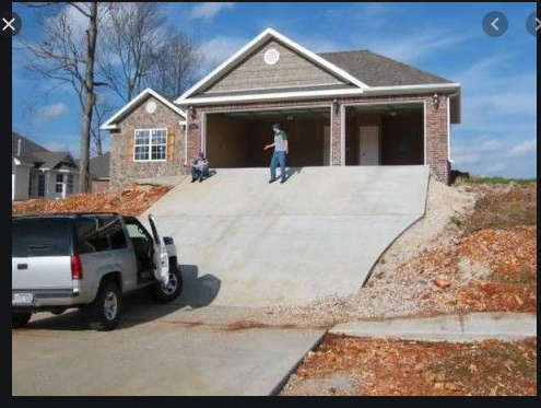

I think your green line is unnecessary. If you take the DTM line (blue line) and position the car central to the change in gradient, there is 18mm of clearance. There is no need to do anything based on the information you have given.
Has the car grounded whilst being driven in, or is someone trying to forsee any possible awkward happenings?
Probably something like this (picture borrowed from web)

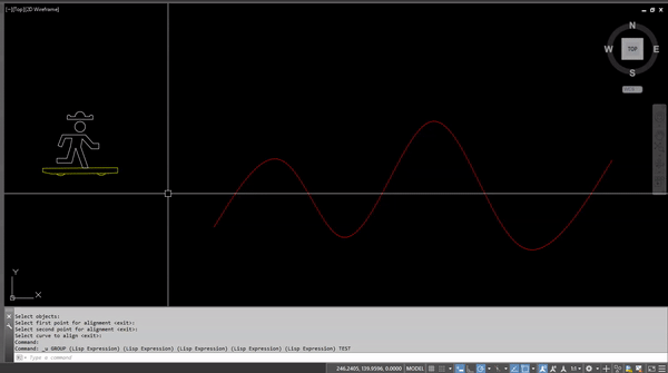

Here's one with animation... Just thought I'd do it for fun cause I'm a little bit bored around.

My $0.05 did this many years ago and same thing uses 2 points. We found it was pretty simple to just zoom in and inspect very obvious were it hit.
As a side note Civil Site Design has this feature and can change vehicle template, can drag car back and forth.
For every one think the other plane ie horizontal just changed the block and spacing now had a forklift path checking for hit racking for a wide load.
Anyway some more theory as you can see this was a day to day check for us road reconstructions. Re the image above  if you do a double reverse curve using a radius of 13m the car will not hit. This is an arc ,the two contact points and the mid underside point. Using this can get a simple how far back does the garage need to be given rise from road.
Re scale as we would test on road cross sections normally plotted at 1:100 V  1:50 H so would block the sheet then change the y scale to 2, then rescale it all 0.1 so now its metric metres then explode so can get at plines.

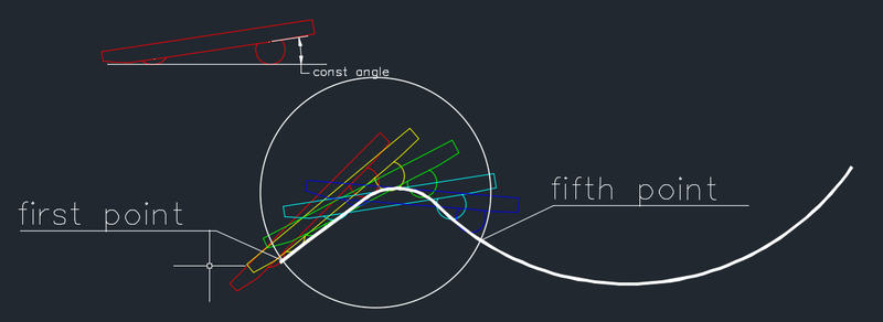

Good morning,
Many times I approached the modification of this wonderful program "foo" so that it was possible to insert a car with different wheels.
I managed to insert cars until there is only one point of intersection of the curve with the circle, when there are two points of intersection, the program stops.
I cannot program it to select the intersection point closer to the end of the curve Please help me with this problem.  My best regards
Short:  in  5 loops  code was break

				       a
				       (setq a 1)
			       '(100 . "AcDbBlockReference")
			       '(2 . "auto")
			       (cons 10 p)
			       '(41 . 0.01)
			       '(42 . 0.01)
			       '(43 . 0.01)
			       (cons 50 (angle p p2))
	     (setq i (+ d i))
	     (entdel xl)
In my code same as other methods I used the quad point of the wheel circles not the wheel centreline. Did you check your wheel spacing v's the 2.4314 if that's metric wow a car wheel spacing  to 4/1000 of a mm.
Post a dwg make sure your block is in it, should be able to test.
Edited by BIGAL
Thanx  a lot for the answer   :) Sorry for my English, I don't always understand the context of the statement. Bat this I undurstend
I didn't even think that the value 2.4314 is so precise, down to 4/1000 of a millimeter   :)"
 This true I  use  metric  I  copied  Your's  block   "auto"  end not scal.
Sir  you  use  inthe code  Xline too  determined the intersection point n+1 using Xline, I don't know exactly how it works. I need to mark point n+1 with a circle or an arc (acrose withe curve), then I know that the intersections will be in the right place
In draw I   explanation in the drawing of what I meant .
I actually realized that I could solve my road light problem. After so many years I'm thinking  about this problem I'm  close, but unfortunately it's too difficult for me to use loops.
Pleas  for the light in tunnel
Regard Woldo
caralign_v10.dwgFetching info...
