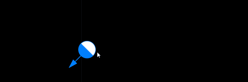

@Ronjonp. It works almost as intended!
The issue for me is that it asks to keep picking points, and when its done, the blocks gets deselected. The idea for me was something like:
  • I have an angle stored in USERR3, and the lisp linked to SHIFT+R
  • I select a block.
  • I press SHIFT+R, and, without asking anything to me, the block turns “USERR3” degrees clockwise around the insertion point, the lisp ends and the block is still selected.
  • If I’d press SHIFT+R again, I turn another “USERR3” degrees clockwise, end again and keep the block selected. Make it 4 times and you are at the beginning.

Glad you got it working :) ... question, why are you set on using the "USERR3" variable? My code above sets a '*fooang* global variable which will hold your value within that session.
Here's an example that should keep the selection highlighted.
(defun c:foo (/ o s)
  (or *fooang* (setq *fooang* (angtof "45")))
  (cond	((and (setq *fooang*
		     (cond
		       ((getangle
			  (strcat "\nEnter rotation angle:<" (rtos (* (/ *fooang* pi) 180.0) 2 0) "> ")
		       (*fooang*)
	      (setq s (ssget ":L" '((0 . "INSERT"))))
	 ;; (while (getpoint "\nKeep picking points to rotate: ")
	 (foreach e (vl-remove-if 'listp (mapcar 'cadr (ssnamex s)))
	   (vla-put-rotation (setq o (vlax-ename->vla-object e)) (+ *fooang* (vla-get-rotation o)))

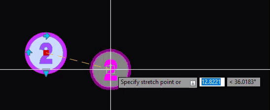

The new code: such rotation, much wow
1 hour ago, ronjonp said:
(defun c:foo (/ o s) (or *fooang* (setq *fooang* (angtof "45"))) (cond ((and (setq *fooang* (cond ((getangle (strcat "\nEnter rotation angle:<" (rtos (* (/ *fooang* pi) 180.0) 2 0) "> ") ) ) (*fooang*) ) ) (setq s (ssget ":L" '((0 . "INSERT")))) ) ;; (while (getpoint "\nKeep picking points to rotate: ") (foreach e (vl-remove-if 'listp (mapcar 'cadr (ssnamex s))) (vla-put-rotation (setq o (vlax-ename->vla-object e)) (+ *fooang* (vla-get-rotation o))) ) ;; ) ;; Highlight selection set (sssetfirst nil s) ;; Regen might be 'heavy' on complex drawings (vla-regen (vla-get-activedocument (vlax-get-acad-object)) 0) ) ) (princ) )
This works great! And in both directions!!!
But it asks me the angle every time. In your "🤩awesome-gif-I-also-wanna🤩" you can rotate several times after putting 25 for example. I can't manage to do it.
What I can do, is make a macro:
^C^C_foo;90;
^C^C_foo;-90;
tied to the shortcuts. I won't be able to change the angle, but the 10% of the times I need another angle, I can use the foo function and not be such a lazy ass...😅
Other than that, works like charm! (pressing multiple times SHIFT+R and CTRL+R):
How great is that!? Look it spin!

Okey, my lazy and greedy mind is now asking...
Could it be possible to do it while dragging a grip?
Like this:
Sorry to give such work!!! 😅
Like this:
If you call the above functions transparently use ' it can be done like so although not sure what is accomplishes 😉
Boooom! Works perfectly!
