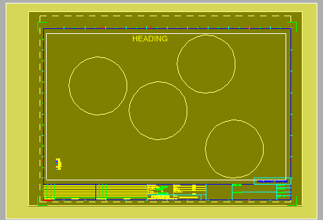

poccles Posted April 20, 2021 Posted April 20, 2021 Hi everyone, Hopefully this isn't too daft a question... I've been asked to now PDF our drawings with a faint yellow background to aid readability for people with dyslexia. I know how to change the paperspace background colour via options/drafting/colours but this seems to only affect the visual appearance within CAD, so when PDFed it reverts to a transparent / default white background. Googling around I can't see another setting anywhere, but may well be missing something. And I've had a look in the PDF plotter options to see if there is anything in there but had no luck. I've also looked at options within Abode Pro as well but there doesn't appear to be a simple setting that will alter the PDF itself rather than the user's settings. I guess there is always the sledgehammer option of a big light yellow hatch but I am wondering if anyone knew of a better approach within CAD. Any pointers/ideas would be appreciated. Thanks! Phil Quote

BIGAL Posted April 20, 2021 Posted April 20, 2021 Thought why not have a go so this was a rectang hatch solid and set to yellow, set draworder back. The only thing was had to set a transparency to the yellow a RGB yellow would be better. I created in Bricscad, it made a pdf and don't have any one to get feed back from but very easy to do. Also play with transparency. Quote

poccles Posted April 22, 2021 Author Posted April 22, 2021 Hi all, Thanks for the responses! Ah, I should've mentioned that these PDFs are for plans which will only every be viewed electronically... they'll never be printed. I agree with Cyberangel that these things are best chosen by the individual user; however, it's an institutional preference to set them to a light yellow background by default as they're viewed on shared terminals used by multiple individuals. The hatching proved to be a bit of a faff with the way the drawings are set up. Turns out there is a way to do it via the background settings within Adode Acrobat Pro. Phil Quote
SLW210 Posted April 22, 2021 Posted April 22, 2021 Acrobat Reader can change the background color as well. Go to Edit>Preferences>Accessibility. P.S. That information was in the link provided by CyberAngel. Quote
