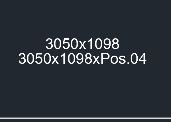

Juergen Posted April 19, 2021 Posted April 19, 2021 Hi, I use the search function from Acad to find all the same text contant and write per hand then the pos at the end of the text. Is there a way to write it automatic? Thx. for your help. Drawing.dwg Quote

Juergen Posted April 20, 2021 Author Posted April 20, 2021 hi tharwat, thanks for your answer. But what i need is all text with the same content should become the same Pos. 3050x489xPos.01 3050x1250xPos.02 3050x544xPos.03 3050x1098xPos.04 3050x1250xPos.02 3050x544xPos.03 3050x489xPos.01 ......and so on Quote
Tharwat Posted April 20, 2021 Posted April 20, 2021 (edited) Then there is no need to convert your Texts to Mtexts, so the following should change the similar text strings automatically that reside into your current active space. (defun c:Test (/ sel lst int ent) ;; Tharwat - Date: 20.Apr.2021 ;; (and (or *inc_* (setq *inc_* 1)) (setq *inc_* (cond ((getint (strcat "\nSpecify increment number < " (itoa *inc_*) " > : " ) ) ) (*inc_*) ) ) (while (and (setq sel (car (entsel "\nSelect Text to add increment suffix : ")) ) (= (cdr (assoc 0 (setq lst (entget sel)))) "TEXT") (setq int -1 sel (ssget "_X" (list '(0 . "TEXT") (assoc 1 lst) (cons 410 (getvar 'CTAB)) ) ) ) (while (setq int (1+ int) ent (ssname sel int) ) (setq lst (entget ent)) (entmod (subst (cons 1 (strcat (cdr (assoc 1 lst)) "xPos." (if (> 10 *inc_*) (strcat "0" (itoa *inc_*)) (itoa *inc_*) ) ) ) (assoc 1 lst) lst ) ) ) (setq *inc_* (1+ *inc_*)) ) ) ) (princ) ) Edited April 20, 2021 by Tharwat Codes added. lol 1 Quote
