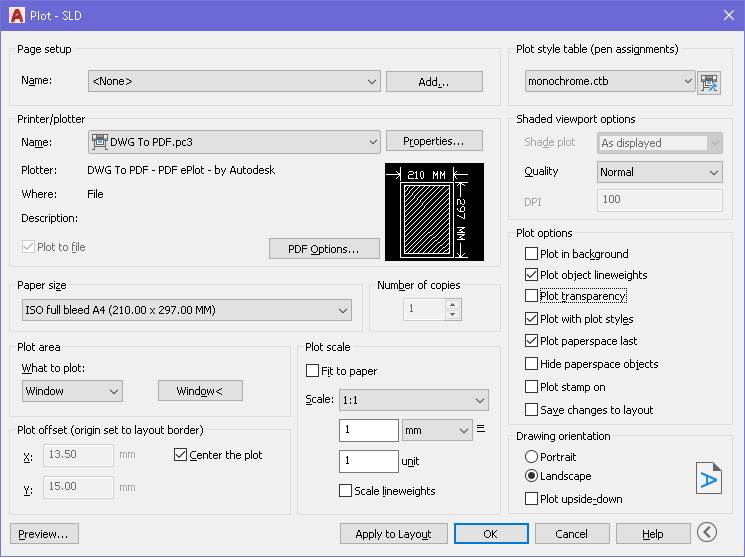

hi all,
while i am printing my files in PDF "OLE Objects plot as black " check the my attached pdf and dwg file
OLE.dwg OLE.pdf
tried this but still result is same... and i want to apply the setting in my other dwg too any other solutions i  also google but not get any solution
You still don't give your plot settings. Try placing your drawing here using eTransmit so everything comes with it.
  • 2 years later...
Click on OLE Object
IN PROPERTIES window, you will see PLOT QUALITY at the bottom. Change it from monochrome to Colour Text or Photograph.
That's all
