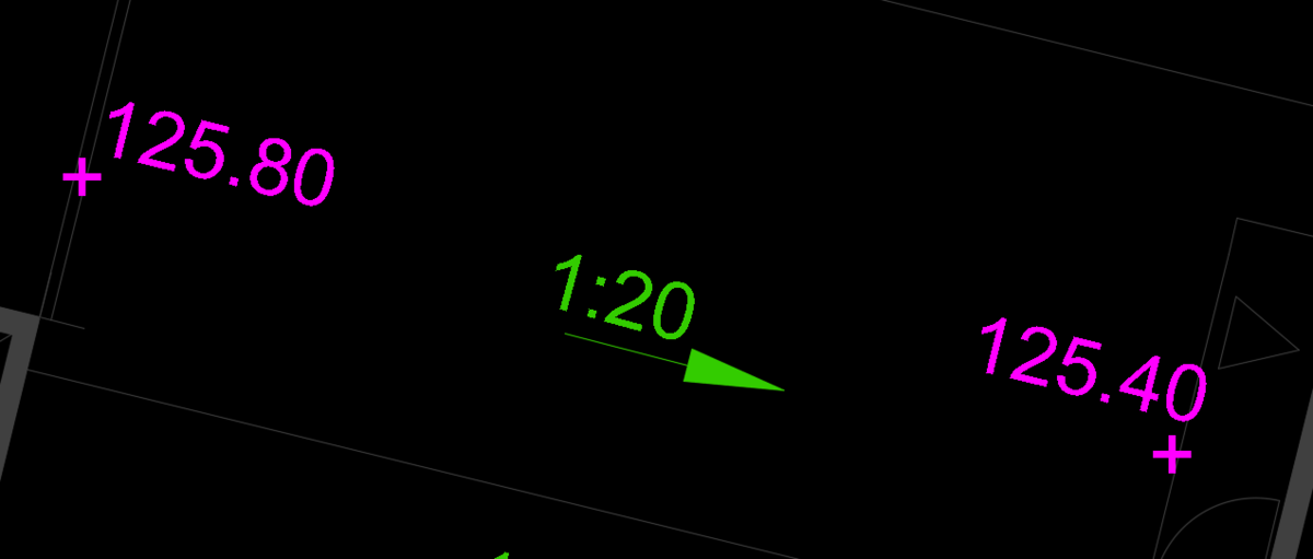

jeppo71 Posted April 19, 2021 Author Share Posted April 19, 2021 Thanks for the response, so starting with the first level of 125.80 which is inputed by the user, then the user specifies the gradient, 1 in 20 in this instance. The user then measures the distance to where the second spot level is needed, then the second spot level is placed at the specified point. Quote Link to comment Share on other sites More sharing options...

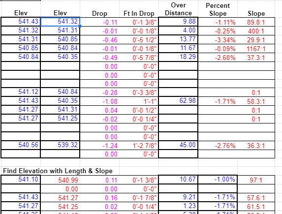

dan20047 Posted April 19, 2021 Share Posted April 19, 2021 Not what you asked, but FYI I use a spreadsheet for my grading, entering either heights or slopes to get new elevations. Has the benefit you can cross reference the heights and distances to allow revisions to all the heights and/or solve from different directions. Here is a link: Grading Blue = data to enter Red / Magenta = formulas Quote Link to comment Share on other sites More sharing options...

jeppo71 Posted April 21, 2021 Author Share Posted April 21, 2021 As we manually input the proposed levels on the external levels drawing, it would be best if the level could be read from the text value, then the measurement can be made from the points. All I need the lisp routine to do is give me the end level at the inputted gradient. Thanks for your help. spot level.dwg Quote Link to comment Share on other sites More sharing options...
BIGAL Posted April 22, 2021 Share Posted April 22, 2021 (edited) Just added a simpler starting sequence just window the text and point as a selection or pick. Thanks Kajanthan for the arrow. ; draw a point by grade ; By AlanH April 2021 (defun xyz ( / obj1 obj2 objname ) (if (= (sslength ss) 2) (progn (setq obj1 (vlax-ename->vla-object (ssname ss 0))) (setq objname (vla-get-objectname obj1)) (if(= objname "AcDbMText")(setq z (atof (vla-get-textstring obj1)))) (if (= objname "AcDbText") (setq z (atof (vla-get-textstring obj1)))) (if (= objname "AcDbPoint")(setq pt1 (vlax-get obj1 'coordinates))) (setq obj2 (vlax-ename->vla-object (ssname ss 1))) (setq objname (vla-get-objectname obj2)) (if (= objname "AcDbMText")(setq z (atof (vla-get-textstring obj2)))) (if (= objname "AcDbTEXT") (setq z (atof (vla-get-textstring obj2)))) (if (= objname "AcDbPoint")(setq pt1 (vlax-get obj2 'coordinates))) ) (alert "to many objects picked ") ) (setq x (car pt1) Y (cadr pt1)) ;(princ (strcat "\nyou now have X Y & Z " (rtos x 2 2)" " (rtos y 2 2) " " (rtos z 2 2))) (princ) ) ;;;; Starts here (defun c:grads ( / pt1 pt2 z xy mp dist ang ss) (setq ss (ssget '((0 . "*TEXT,POINT")))) (setq oldaunits (getvar 'aunits)) (setvar 'aunits 3) (xyz) (command "-layer" "M" "Arrow" "") (setq pt2 (getpoint pt1 "Pick 2nd point for ang and distance ")) (setq ang (angle pt1 pt2)) (setq dist (distance pt1 pt2)) (setq grad (getreal "\nEnter gradient X ie 1:X ")) (setq Z (+ Z (/ dist grad))) (command "point" pt2) (command "text" pt2 0.5 0.0 (rtos z 2 3)) (setq mp (mapcar '* (mapcar '+ pt1 pt2) '(0.5 0.5 0.5))) (entmakex (list (cons 0 "LWPOLYLINE") (cons 100 "AcDbEntity") (cons 100 "AcDbPolyline") (cons 8 "Arrow") (cons 90 3) (cons 70 1) (cons 40 0.1) (cons 41 0.1) (cons 10 (polar mp ang (- 1.5) )) (cons 40 0.1) (cons 41 0.1) (cons 10 (polar mp ang 0.5 )) (cons 40 0.5) (cons 41 0.0) (cons 10 (polar mp ang 1.5 )) (cons 40 0.0) (cons 41 0.0) ) ) (setq pt2 (polar mp (+ ang (/ pi 2.0)) 0.5)) (command "text" pt2 0.5 ang (strcat "1:" (rtos grad 2 1))) (setvar 'aunits oldaunits) (princ) ) Edited April 22, 2021 by BIGAL 1 Quote Link to comment Share on other sites More sharing options...

BIGAL Posted April 22, 2021 Share Posted April 22, 2021 Sorry left some test stuff in it removed working now only thing to add is a "text readable". POST UPDATED. 1 Quote Link to comment Share on other sites More sharing options...
jeppo71 Posted April 23, 2021 Author Share Posted April 23, 2021 Many thanks for this its very good. The only tweak I would make would be to change the arrow direction if possible. On a positive gradient entry if the arrow can be rotated 180 degrees, and for a negative gradient the arrow just remain as you've showed it. We always show the arrow pointing to the low point. Don't worry if it's an issue I can work with what I have an just rotate the arrow manually. But in any case thank you for your help. Quote Link to comment Share on other sites More sharing options...
BIGAL Posted April 23, 2021 Share Posted April 23, 2021 Sounds like a good time to learn lisp, if you look at the (10 . in the pline entmake which is the arrow, you can just change the ang variable to (setq ang (- ang)) but you will need a test is grad -ve dont change, have a go. If get stuck post. 1 Quote Link to comment Share on other sites More sharing options...
