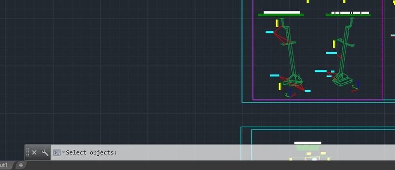

Nick24 Posted April 16, 2021 Author Share Posted April 16, 2021 (edited) 12 hours ago, mhupp said: ;;----------------------------------------------------------------------;; ;Zoom Extents and TTT command (defun C:ZE (/ SS) (command "_.Zoom" "E") (if (setq ss (ssget "X" '((0 . "*TEXT")(62 . 7)))) (C:TTT) ) ) To call other commands inside of a lisp you just have to wrap it with ( ) this will zoom extents and then make a selection set SS of all text and mtext that are color 7. if their is text that match that it will run TTT command. if TTT doesn't use SS for the selection set rename the variable to what ever TTT uses. or if TTT can handle all the selecting the text you just need. ;;----------------------------------------------------------------------;; ;Zoom Extents and TTT command (defun C:ZE (/) (command "_.Zoom" "E") (C:TTT) ) Thanks for the answer! Your routine is almost what i need, only thing is that it does not select the text i want. See below screenshot. It stops before selecting the text. I assume there's a problem with ssget function. I can attach TTT function if needed. Edited April 16, 2021 by Nick24 Quote Link to comment Share on other sites More sharing options...

Nick24 Posted April 16, 2021 Author Share Posted April 16, 2021 1 minute ago, mhupp said: It would help. just to see how its handling the selection of text. Please see below. In principal, i want it to zoom extents => select all texts with colour 7 => run TTT command. If you know other way to achieve this , other then what i pointed to, it's just as good. Thanks again! (defun LM:writecsv ( lst csv / des sep ) (if (setq des (open csv "w")) (progn (setq sep (cond ((vl-registry-read "HKEY_CURRENT_USER\\Control Panel\\International" "sList")) (","))) (foreach row lst (write-line (LM:lst->csv row sep) des)) (close des) t ) ) ) (defun LM:lst->csv ( lst sep ) (if (cdr lst) (strcat (LM:csv-addquotes (car lst) sep) sep (LM:lst->csv (cdr lst) sep)) (LM:csv-addquotes (car lst) sep) ) ) (defun LM:csv-addquotes ( str sep / pos ) (cond ( (wcmatch str (strcat "*[`" sep "\"]*")) (setq pos 0) (while (setq pos (vl-string-position 34 str pos)) (setq str (vl-string-subst "\"\"" "\"" str pos) pos (+ pos 2) ) ) (strcat "\"" str "\"") ) ( str ) ) ) (defun C:ttt(/ lst ss i el x fn) (setq lst (list) ss (ssget (list (cons 0 "TEXT"))) ) (repeat (setq i (sslength ss)) (setq x (ssname ss (setq i (1- i)))) (setq el (entget x)) (if (= (cdr (assoc 0 el)) "TEXT") (setq lst (append lst (list (list (cdr (assoc 1 el)))))) ) ) (setq fn (vl-filename-mktemp nil nil ".csv")) (if (and lst (LM:WriteCSV (reverse lst) fn)) (startapp "explorer" fn) ) ) Quote Link to comment Share on other sites More sharing options...
mhupp Posted April 16, 2021 Share Posted April 16, 2021 Change the following in your lisp (setq lst (list) ss (ssget (list (cons 0 "TEXT"))) ) to (setq lst (list) ss (ssget "X" '((0 . "*TEXT")(62 . 7)))) ;this wont prompt to select objects b/c it selects everthing then filters down to text that are color 7 and then use the following ;;----------------------------------------------------------------------;; ;Zoom Extents and TTT command (defun C:ZET (/) (command "_.Zoom" "E") (C:TTT) ) I don't think this will work if the text you are trying to select are in blocks. Quote Link to comment Share on other sites More sharing options...
Nick24 Posted April 16, 2021 Author Share Posted April 16, 2021 50 minutes ago, mhupp said: Change the following in your lisp (setq lst (list) ss (ssget (list (cons 0 "TEXT"))) ) to (setq lst (list) ss (ssget "X" '((0 . "*TEXT")(62 . 7)))) ;this wont prompt to select objects b/c it selects everthing then filters down to text that are color 7 and then use the following ;;----------------------------------------------------------------------;; ;Zoom Extents and TTT command (defun C:ZET (/) (command "_.Zoom" "E") (C:TTT) ) I don't think this will work if the text you are trying to select are in blocks. Unfortunately, the result is the same. It still stops at selecting texts and asks me to select what i want before proceeding with TTT command. PS: No texts are in blocks. Quote Link to comment Share on other sites More sharing options...
