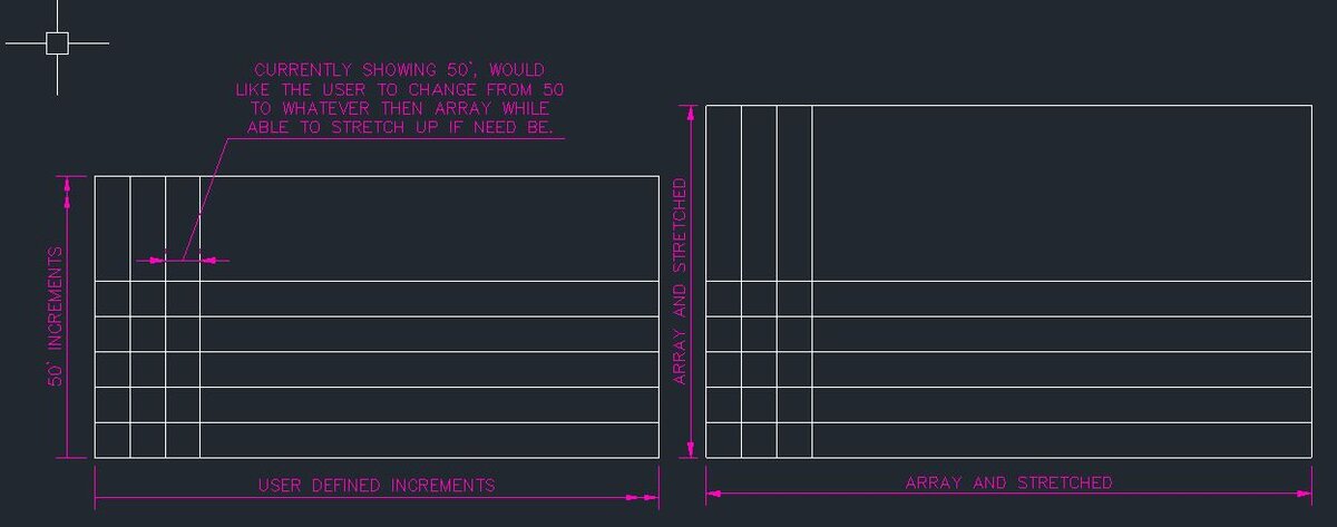

I hope this picture makes more sense to what I am trying to achieve. I would like to be able to stretch the outside rectangle while arraying the vertical line inside the rectangle to a user defined distance.
I was able to created one using visibility states, for example 50' 52' 64' 56' 58' 60'. But that was alot of visibility states.
You could do from 1st principles using a lisp enter values and draw it. If that is ok to not use a dynamic block. Could group so is like a block.
