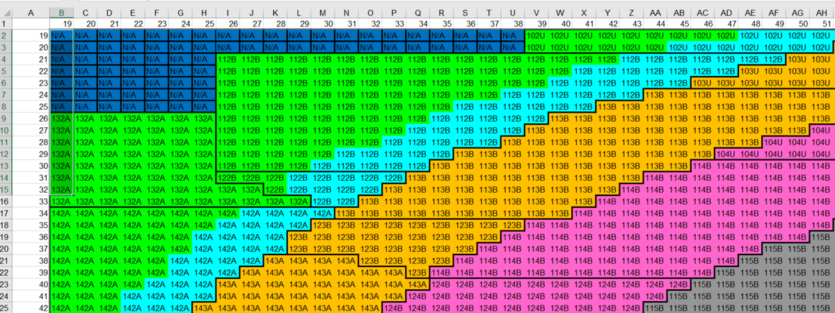

BIGAL Posted April 8, 2021 Posted April 8, 2021 (edited) I am getting a bit lost in 6 options for every size. This is a look up table variables read from the block its uses my Multi radio buttons lisp so does not matter how many values are in the dynamic block look up max about 20. AS I said the length and width is worked out from a pick point inside a rectang using bpoly. So long as its a closed shape bpoly will work so lines plines are ok. I think I understand and you want lookups and 2 visibilty states. I do very little with Dynamic blocks so maybe 1st step is the inside and outside you may just be able to set a distance variable to Zero ie the 0.5 so no need for a visibilty state. d3 = d1+d2 Once you have the dynamic block can help you with a front end. Edited April 8, 2021 by BIGAL Quote
resullins Posted April 9, 2021 Author Posted April 9, 2021 Ah... ok, so each size (there are 28), requires 8 options. Spacings: Off, 1.0625, 1.25, and 1.5, and each of those options needs to show either a surface or flush mount option. So that's a total of 224 vis. states. I tried to do the sizing of the panel with stretch or scale actions instead of vis. states, but since the different spacings have to array differently, it was causing issues. I'll post the block when I'm finished so you can take a look at what I'm doing. I know my explanation is a little wanton without visibility. Now, I did finally find a tutorial video online about the lookup table trick that actually made sense to me! So that was really helpful! And I'm just going to bite the bullet and do it that way. I'm currently done with about 160 of them... only 64 left to go. Quote
BIGAL Posted April 10, 2021 Posted April 10, 2021 (edited) I did a look up table in lisp it was the equivalent to a Row Col in excel lookup, it was a length, width, so say 22,33 would be the equivalent to a double nth of a list, it removed the need to talk to excel. The 1st list was the width and can see the row value was length ; (list 0 19 20 21 22 23 24 25 26 27 28 29 30 31 32 33 34 35 36 37 38 39 40 41 42 43 44 45 46 47 48 49 50 51 52 53 54 55 56 57 58 59 60 61 62) (list (list 19 N/A N/A N/A N/A N/A N/A N/A N/A N/A N/A N/A N/A N/A N/A N/A N/A N/A N/A N/A N/A 102U 102U 102U 102U 102U 102U 102U 102U 102U 102U 102U 102U 102U 102U 102U 102U 103U 103U 103U 103U 103U 103U 103U 103U) (list 20 N/A N/A N/A N/A N/A N/A N/A N/A N/A N/A N/A N/A N/A N/A N/A N/A N/A N/A N/A N/A 102U 102U 102U 102U 102U 102U 102U 102U 102U 102U 102U 102U 102U 103U 103U 103U 103U 103U 103U 103U 103U 103U 103U 103U) (list 21 N/A N/A N/A N/A N/A N/A N/A 112B 112B 112B 112B 112B 112B 112B 112B 112B 112B 112B 112B 112B 112B 112B 112B 112B 112B 112B 112B 112B 112B 112B 112B 103U 103U 103U 103U 103U 103U 103U 103U 103U 103U 103U 103U 103U) another 60 lines (setq ans (nth (- col 1) (nth (- row 1) lst))) Edited April 10, 2021 by BIGAL Quote

BIGAL Posted April 13, 2021 Posted April 13, 2021 (edited) The example was a look up table from excel that uses a row column look. I exported the sheet out as csv then replaced , with space added a couple of (list and ) and all done. It use a double nth (nth row (nth col lst)) I had 9 sheets 1 for each type. Edited April 13, 2021 by BIGAL Quote
