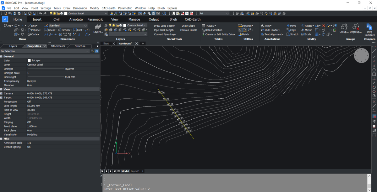

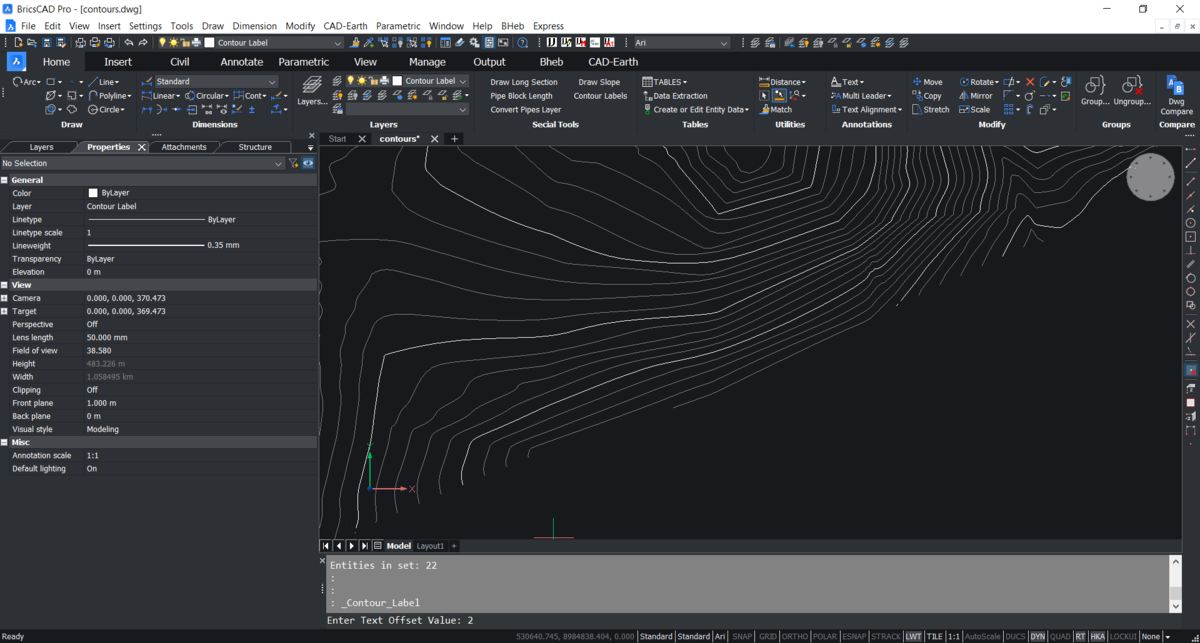

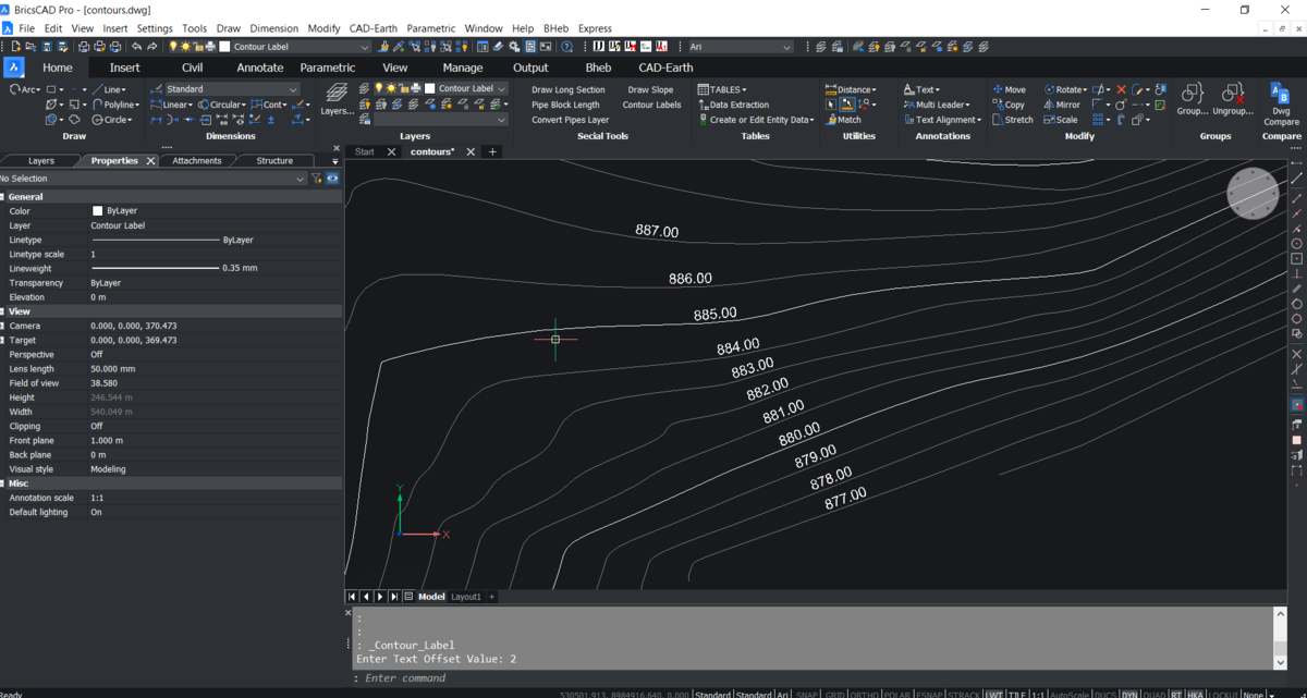

aridzv Posted April 12, 2021 Author Share Posted April 12, 2021 (edited) @Trudy see the attached screen shots. after launching the command: 1. set the offset dist and press ENTER. (the problem here is that if you press ENTER with out give a value the lisp crash...) 2.with the left click pressed drag the mouse over the contours you want to label. 3. when done let go of the left click and press enter again to exit the lisp,or press and hold the left click to draw more labels in another direction. Edited April 12, 2021 by aridzv Quote Link to comment Share on other sites More sharing options...
Trudy Posted April 12, 2021 Share Posted April 12, 2021 I try on civil 2012 and cant do nothing. I will try later again but for now dont work. Quote Link to comment Share on other sites More sharing options...
aridzv Posted April 12, 2021 Author Share Posted April 12, 2021 (edited) @Trudy O.K. - I know what is the issue: 1.the contours MUST be in layer "Contour Major" Or "Contour Minor". you should create those layers and move the contours to them. 2. the contours MUST be LWPOLYLINE, not 3d poly or 2d poly (not x,y,z - but x,y and ELEVATION) *About the layers issue - I don't know how to cancel this condition, maybe you will be able to help here to... Edited April 12, 2021 by aridzv Quote Link to comment Share on other sites More sharing options...
