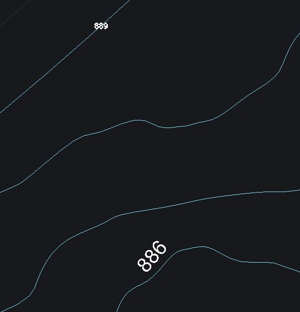

there 4 things I would change:
1. I would use regular text instead of the block.
2. I would enable the user to set the text height.
3. I would change the location of the text to be above the contour line.
4. if possible, align the text to the contour (I Guess this will be hard to do...).
I've attached screenshot of the results from your routine compared to the original- the small size value (889) is yours and the big one (886) is from the original.
and again - MANY THANKS!!!
Ari.

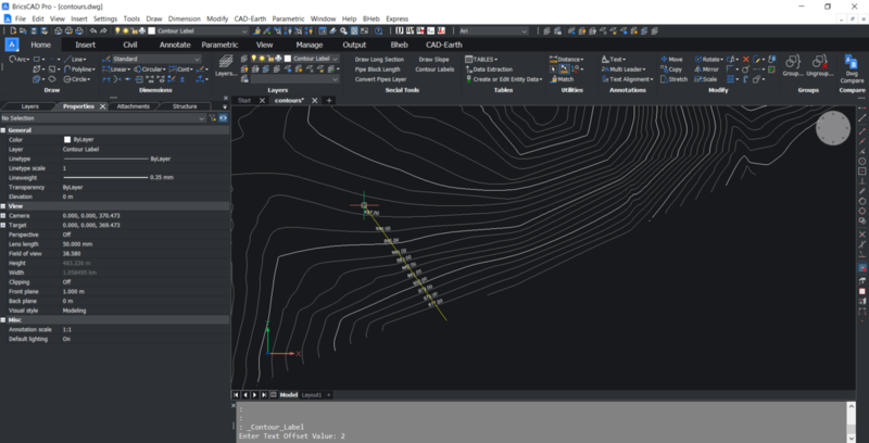

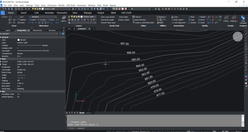

I cant start this lisp for some reason :D
If you want i can try to change my come more. With offset from line and diff layers i thik it will not be problem to make it work with 3dPoly.
 @aridzv
@Trudy
read the instructions in the lsp file header.
see the new attachment here.
I've added an option to set the offset distance, but I cant set a default value...
see if you can help...
Contour_Label.lspFetching info...
