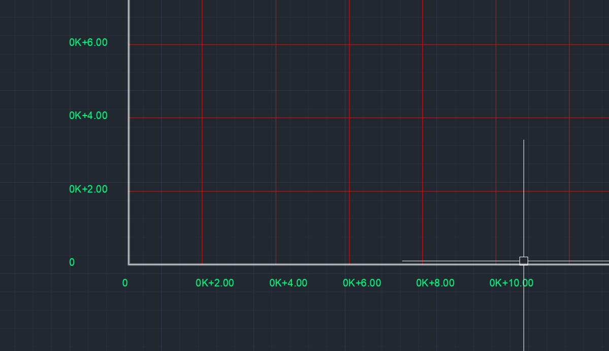

Dear ALL:
This LISP "DCDD" , it is according to Y axis (vertical) to increment the number.  and with TEXT type (0K+00   0K+01  0K+01.55  ......)

But i want to change to according to X axis (horizontal) . How to edit?

Unfortunately, it is no with TEXT (like 0K+  ) and  NOT second decimal place..
How To Comprehensive The two LISP
Please Helep me

Further Explanation.
Here is "DCDD" operation , that horizontal is still  ZERO
So I would like to the "CPT" function could write into "DCDD"

Now, I modified some,
Now you can apply both ways with this lisp.
