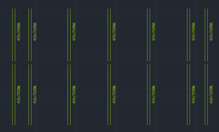

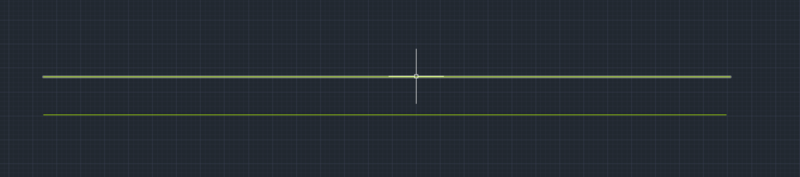

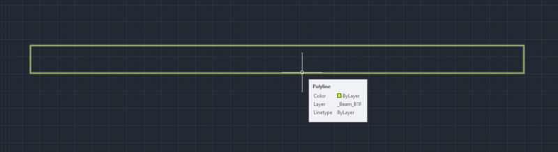

KevinAlc0r Posted March 23, 2021 Share Posted March 23, 2021 Hi all, Are there any LISP routine that can help me to create enclosed polyline from parallel line as shown below: 1. First, I have the parallel individual lines as shown below: 2. I want to know if any LISP exists that converts both Lines into an enclosed single PolyLine objectas shown below: I tried Lee Mac's Polyline LISP (http://www.lee-mac.com/polylineprograms.html), especially the Polyline Join and Close command, but the only part that works is the Polyline Join command which transform each Line objects into Polylines but the Polyline Close command can't close the polylines together. I guess Lee Mac's LISP was not intended for my case. Any help would be greatly appreciated! Thanks in advance! Quote Link to comment Share on other sites More sharing options...

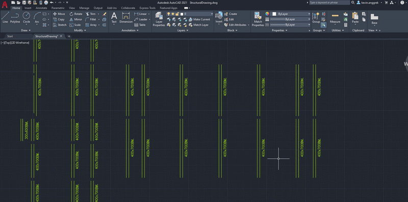

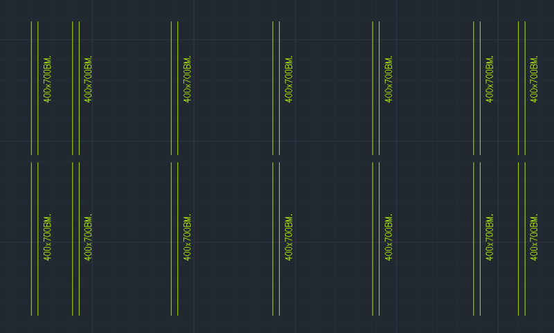

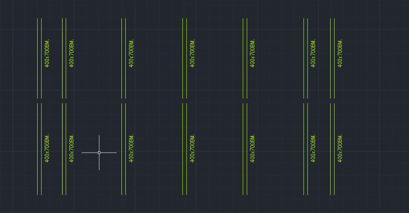

KevinAlc0r Posted March 24, 2021 Author Share Posted March 24, 2021 Dear @BIGAL Thank you Sir/Madam for the LISP, it works exactly just like what I needed. Since I am pretty new to AutoLISP, is there a way to automate this LSIP routine/process on multiple parallel lines at the same time? For example if I have multiple parallel lines as shown below: Thank you! Quote Link to comment Share on other sites More sharing options...

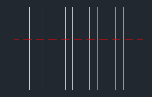

BIGAL Posted March 24, 2021 Share Posted March 24, 2021 (edited) Yes there is a simple solution I almost did the original code that way. You just pick based on image left side then right side so a selection of all the lines is made, a simple check of the order is carried out ie left to right, then its just pairs and code as posted used. Obvious is 1st check must be equal number of lines. Need a bit of time have to find the routines in other code. For your image will need to run twice. Edited March 24, 2021 by BIGAL Quote Link to comment Share on other sites More sharing options...

KevinAlc0r Posted March 25, 2021 Author Share Posted March 25, 2021 Big thanks @BIGAL for the second version. I have tried the second version and it works just like the following: The lines are also turned into Polylines automatically! Once again, Thanks a lot! Quote Link to comment Share on other sites More sharing options...

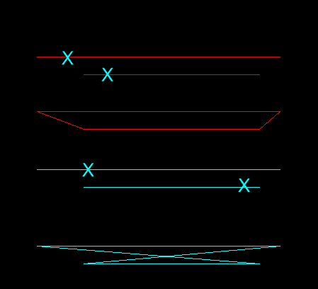

BIGAL Posted March 25, 2021 Share Posted March 25, 2021 (edited) To make life easier for you drag line say near end but down a bit make sure you are " outside" both ends look at image. See red dashed line. You dont have to touch outside lines, so long as pt2 drag crosses the lines. Same left right, right left will work same as up down etc. Oh yeah dont do a cross diagonal will get bowties. Edited March 25, 2021 by BIGAL Quote Link to comment Share on other sites More sharing options...
KevinAlc0r Posted March 25, 2021 Author Share Posted March 25, 2021 You mean by dragging from left to right like this? Quote Link to comment Share on other sites More sharing options...

KevinAlc0r Posted March 26, 2021 Author Share Posted March 26, 2021 Wow, marvelous @Tharwat, I tried your LISP and it works wonders! It reduced the amount of time needed to do these repetitive tasks. If I understand it correctly, @ronjonp's code snippet is used as a proper way to remove items from lists inside a loop right? Quote Link to comment Share on other sites More sharing options...
eldon Posted March 26, 2021 Share Posted March 26, 2021 The end product looks just like a rectangle. Perhaps it should have been drawn as a rectangle in the first place? Quote Link to comment Share on other sites More sharing options...
KevinAlc0r Posted March 26, 2021 Author Share Posted March 26, 2021 Hi @eldon, I specifically asked for this LISP because I noticed that multiple drawings of beams or walls are drawn as a pair of parallel lines. However, I am creating a Revit add-in to create walls from 2D CAD drawings and for it to work properly, I need the drawings to be turned into Polylines as quickly as possible. That is why they are not drawn as rectangles in the first place Quote Link to comment Share on other sites More sharing options...
