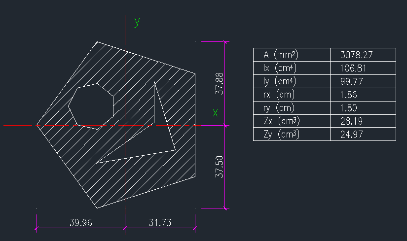

I have searched all over the internet and could not find any workable autolisp file to output the First moment of area (Plastic section modulus) for a region.  Any of you guys have such a file?  I have a autolisp which can output area, second moment of inertia and elastic modulus as attached.  I would like to find a way to add two lines, which include the Plastic section modulus for x and y direction.  Even an independent autolisp for Plastic section modulus would be great! Thanks!

You can calculate the first moment of an area in AutoCAD using the massprop command to find the centroid of the entire shape and then for the first moment, massprop could be used to find the centroid and area for the shape above the specified axis.

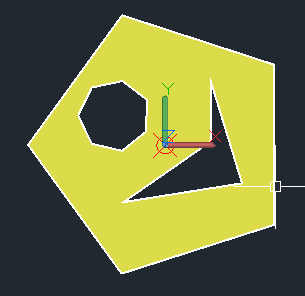

For example,  the image below shows an approximation of the  shape you posted. I traced it in AutoCAD and then scaled it appropriately.  Using the boundary command a region was created. Massprop was used to find the centroid of the region.  The shape was then moved so that its centroid was at 0,0.
As a check, the massprop command was given again with the centroid at 0,0 with the following results:

These values of the approximate shape agree closely to the values in your drawing (multiplying your numbers by the 1000 for cm^3 or 10000 for cm^4)

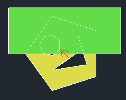

A rectangular region is then added over the top half of the shape.

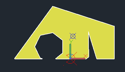

Applying a Boolean intersect yields just the top half of the shape.
The massprop command is used again to compute the centroid (blue point below) of the top half shape and its area which yields the y coordinate of the centroid as 16.2917 and the  area of   1514.0829.
The first moment for the horizontal axis is the product of the distance to the centroid and the area.
d * A = (16.2917) * (1514.0829) = 24,667 mm^3

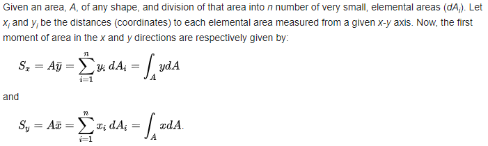

@BIGAL  Ix/Cx would return elastic modulus instead of plastic modulus (or first moment of area).
@lrm  The method you suggested (area above centroid) would be a reasonable approximation, I believe.  If possible, I would like to have a more exact output using the half area concept though.
