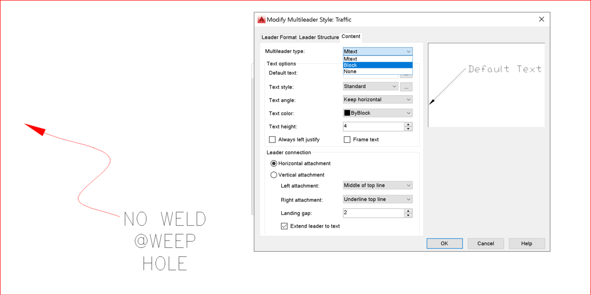

Dadgad Posted March 19, 2021 Share Posted March 19, 2021 (edited) The blocks can be used as Default content in the MULTILEADER STYLE dialog. Please don't be confused by the Spline leader displayed in the screenshot. That is the one I use for leaders in my work, changes are available on the Leader Format & Leader Structure Tabs. Having just reread your original post, it sounds like this is functionality of which you are already aware. BIGAL may well be onto something, with his alternate approach. He has history with this sort of work, whereas I do not. Edited March 19, 2021 by Dadgad typo Quote Link to comment Share on other sites More sharing options...

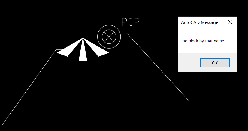

rcb007 Posted March 19, 2021 Author Share Posted March 19, 2021 Gotta question for you if you dont mind. I started a blank dwg, Created a block called "stop" with text in it. I then dragged the routine in, and typed "tstop". Not sure if i did something wrong with the command reject of _.Mleader or not. But again, thank you. Command: tstop Pick landing point Pick next point ; error: AutoCAD command rejected: "_.Mleader" Unknown command "TSTOP". Press F1 for help. Quote Link to comment Share on other sites More sharing options...
BIGAL Posted March 20, 2021 Share Posted March 20, 2021 It was working so I am not sure why it stopped tested in Bricscad and works fine. Did test also in Autocad will go back and work out why not working today. I have updated code above it was definitely working yesterday in Autocad. Blocks can not have spaces in name but there is a way around that, let me know if it is an issue. Quote Link to comment Share on other sites More sharing options...
rcb007 Posted March 22, 2021 Author Share Posted March 22, 2021 I did some testing this morning. I am still getting the same results within Civil3D 2020. I tried the same thing in Civil3D 2018 and Civil3D 2018 as AutoCAD. I started a new blank Out of the box AutoCAD template. I made sure the current MLeader Style was standard, with Standard text. I created a new block name stop. I ran the routine with a "tstop" and still getting the Autocad command rejected: "_.Mleader". Unknown command "tstop". Is it possible that i may have setting with my setup that will not allow reactors to work? That is the only this i can think of, that would possibly giving me the error that i see. thanks again and i am not trying to be pain! lol Quote Link to comment Share on other sites More sharing options...

BIGAL Posted March 22, 2021 Share Posted March 22, 2021 (edited) I have double checked the updated code is definitely their now and uses the vla-sendcommand method, not sure why it did not update before I must have clicked wrong button or something, tested in Autocad and Bricscad. Bricscad can be a bit more forgiving when coding and often works where Autocad does not. Edited March 22, 2021 by BIGAL 1 Quote Link to comment Share on other sites More sharing options...
rcb007 Posted March 23, 2021 Author Share Posted March 23, 2021 This rocks! thank you so much! Just tested it and I can see the same results that you have! Quote Link to comment Share on other sites More sharing options...
