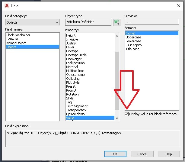

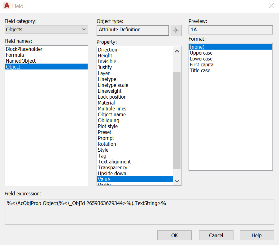

resullins Posted March 18, 2021 Share Posted March 18, 2021 Morning Boys and girls. I have a block... pretty simple, where I want one of the attributes to appear twice. Basically, you enter it once and it updates in two places. I KNOW for a fact I've done this before with a field. But I'm attempting it again, and I can't get it to work. It's not updating. I currently have it set to an Object's value. And when I insert it it will take the initial value of the attribute (or default value), but won't update itself when I change the value. FIELDEVAL is set to 31. I'm sure I just have the wrong FIELD settings. Could someone smack the right answer into me please? Thanks! Quote Link to comment Share on other sites More sharing options...

steven-g Posted March 19, 2021 Share Posted March 19, 2021 HaHa Got it. Simple when you know how You need to tick the box to show values for the block reference. 1 Quote Link to comment Share on other sites More sharing options...
resullins Posted March 19, 2021 Author Share Posted March 19, 2021 I saw that first thing and went back to my block, broke it down and added an attribute with that checked... and it still didn't work. Did you get it to on my block? Quote Link to comment Share on other sites More sharing options...
steven-g Posted March 19, 2021 Share Posted March 19, 2021 Yeah worked straight away. _CG_FLAG (1).dwg 2 Quote Link to comment Share on other sites More sharing options...
