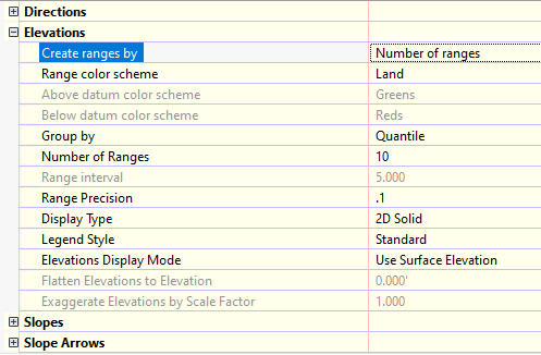

Go to the current Surface Style.
How many ranges are shown there?
What is your elevation range? Mine is from 3' to 22' and this is the result.
Not sure why it auto-configured the first range from 3 to 3 ?
Thanks for the reply rkmcswain.
Mine was set to 1 but even if I change it to 8 I still can get more than 2 ranges.

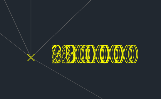

I just tried your data and it has some odd things about it. there are 29 points each with the same X & Y in one location no wonder its not working just look at this image your data this would be vertical faced triangles not a good idea. You need to look seriously at the data its not CIV3d.
