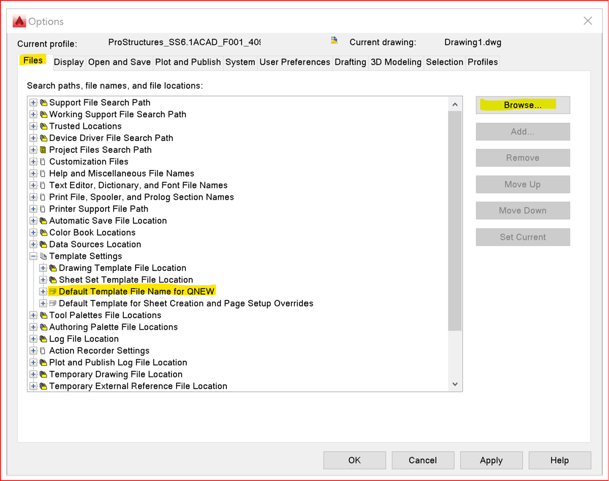

Dadgad Posted March 9, 2021 Share Posted March 9, 2021 (edited) The good new is that ANY drawing can be saved using the SAVE AS option, as a .dwt (template file). You may want to go into Modelspace and delete any job specific objects. Don't PURGE it, or do so carefully, because there will be lots of settings and styles which your friend favors in place in the drawing. The next time you do something for him, use it, and it will already be tweaked just as desired. It is a good idea to create a library of .dwt files, for different tasks, vendors, etc.. No point in reinventing the wheel every time you saddle up. Later just hit the open icon and in the Files of type drop down list choose .dwt to find and access it. Edited March 9, 2021 by Dadgad Screenshot added. 1 Quote Link to comment Share on other sites More sharing options...

Dadgad Posted March 9, 2021 Share Posted March 9, 2021 Glad I could help you. Additionally it is worth noting that it is within your power to redefine your QNEW drawing to use whichever of your template files is most appropriate. Whenever your personally defined DEFAULT QNEW template is inappropriate for the task at hand, use that OPEN option to choose another. Quote Link to comment Share on other sites More sharing options...
