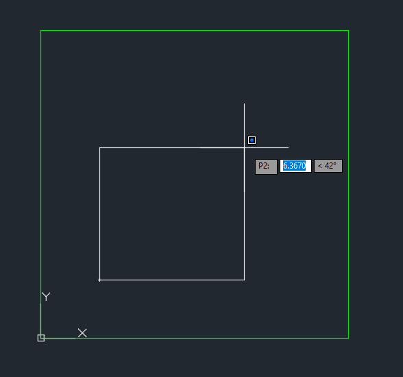

Hello, I have a fuction that create a list of points to grvecs draw alot of retangle on the screen (like the simple example above):
(defun points nil
(list 3 (list 00 00) (list 00 10)
      3 (list 00 10) (list 10 10)
      3 (list 10 10) (list 10 00)
      3 (list 10 00) (list 00 00)
Now I need to get two points, but if a move the screen ou zoom in/out the draw dissaper .
I belive I need to use grread and redraw everytime, but I dont know how do this with getpoint and getcorner.
(defun c:test()
(grvecs (points))
;(while....
;(grvecs (points))
(setq p1 (getpoint "P1: ")
      p2 (getcorner p1 "P2: "))
Something like this ?

Thank you for reply, but No,
I need the (grvecs (points)) always display the square (the square is just a example, the real fuction draw many squares) while I will get the p1 and p2, but If I pan/ or zoom in/out the square disappear.
Why not use a temp rectangle then delete it? Might help if you posted the actual code you're using too.
