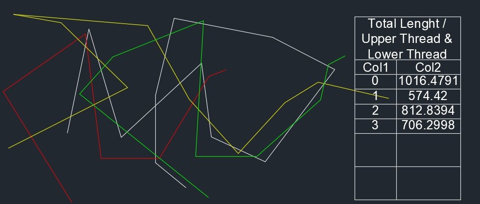

i need help to resolve my problem! any help!?
setq ln (nth 0 l)
24 minutes ago, PedroSoa said:
can have the value!
I believe you have to check your code some more. Your if statement has 3 arguments while only 2 are allowed
Besides that , in your if statement you (defun SEAM ...) but never use (call) it

thanks a lot rlx! how i am having trouble to insert upperthread on the table!

could you post an example  / image / drawing of how your output / table should look like
Yes I see the same. But you want to show upper / lower something , so how should that look like?

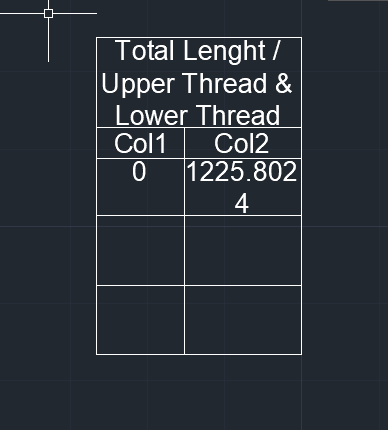

normally i chose seam 301 and 24 density!
still not sure what your program is actually used for , calculate length of sewing thread or something? anywayz maybe this is what you mean?

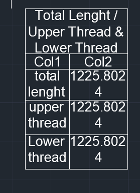

I just use append command to add two rows to your list (at the back of your list)
;;; add upper & lower tread to list
  (setq lst (append lst (list (list "Upper Thread" upper) (list "Lower Thread" lower))))
it would be nice when asking for seam type and stitch density to include the options like :
"\nEnter Seam Type (301 or 401) : " and for density  "\nEnter Stitch Density (1-10) : " or something
yes! perfect ! thank you very much!

one question! can i take the zero from the table and add lenght ?!
hi, one question! can i take the zero from the table and add text lenght ?!
replace
(setq lst (cons '("Total Length / Upper Thread & Lower Thread") lst))
with
(setq lst (vl-remove nil (list '("Total Length / Upper Thread & Lower Thread") (car lst)
    (list "Length" (cadadr lst)) (cddr lst) (list "Upper Thread" upper) (list "Lower Thread" lower))))
