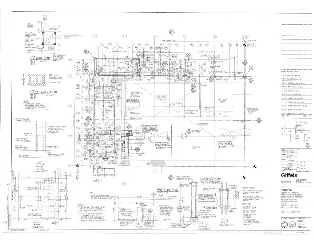

Marissa Maggard Posted March 5, 2021 Author Share Posted March 5, 2021 These are the current plans he has. One is just the original plan and the other is one he just edited himself with a different software. He's basically wanting me to be able to make it look more professional in CADD and then put it on a sheet with our company logo and all that. I'm not quite for sure what to do. 400-A1_-_PARTIAL_FLOOR_PLAN.pdf Quote Link to comment Share on other sites More sharing options...
Cad64 Posted March 5, 2021 Share Posted March 5, 2021 Well, you do have dimensions on the plan, so you can scale the pdf in model spaced, based on those. It won't be exact, but you should be able to get it pretty close. The enlargements all say what scale they are, so you can create individual viewports in paper space for each of those. For the plan, in paper space, create a viewport and set the viewport scale to something reasonable that fits your sheet size and reads well. You may want to put the details on a 2nd sheet so you have more room to put your notes and callouts on the plan. Quote Link to comment Share on other sites More sharing options...
ammobake Posted March 6, 2021 Share Posted March 6, 2021 (edited) The first step is establishing existing conditions and having them in CAD. If you don't have them in CAD and have no way to acquire the existing CAD files, you have work ahead of you to asbuilt the existing structure and draw it from scratch. It can take days to measure everything out, get door sizes, window sizes, lid heights, sketch it out, etc... But it's the only way to draw it from scratch in CAD. If all you have is a PDF, it is possible to import it to Autocad but only if it was created in Autocad. In some cases it might be faster to insert the PDF at 100% scale and trace it out but it would be less accurate. From there, you or your client need to determine what the final floor plan should be based on that existing layout. At that point, the new construction layer will guide you in determining exactly what walls, doors and windows need to be demolished. And you can denote those areas to be demolished on a demo plan with a red cross hatch (is my typical method). With special notes and instructions given for specific windows, doors, etc.. It is 100% necessary to have the existing floor plan (CAD) and the new proposed floor plan (CAD) to accurately draw a demolition plan. -ChriS Edited March 6, 2021 by ammobake Quote Link to comment Share on other sites More sharing options...
BIGAL Posted March 6, 2021 Share Posted March 6, 2021 A couple of extra comments the pdf is scanned and it has a skew but that can be fixed use "Align" to rotate and scale. Ok the fun bit pdfattach put say 0,0 scale 1 When you look at the pdf there is "5 bays @ 64' = 320" so a good dim the bigger is best to use. Now I did DI and the length of the 5bays was 0.13 so 320/0.13 = 2461 so I scaled the pdf 2400 Using Line I picked the left arrow of the 320 long, made sure ortho was on dragged mouse to right typed 320 so end up with line 320 long and more important square. Now "Align" pick pdf, make sure you snap endpoint, pick left point of line as pt1, pick to pt same point, pick the arrow head right side of 320, then the right end of the line , press enter, do you want to scale YES. Its at least now somewhere closer. Like others I would trace over it, use Mline for walls etc. Quote Link to comment Share on other sites More sharing options...
