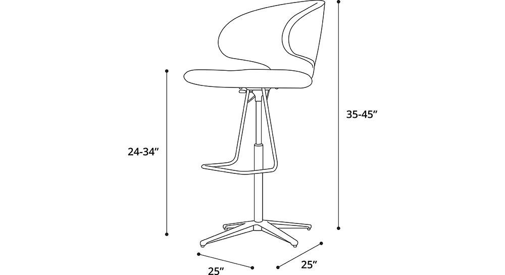

Like f700es I play on the edges with 3d, but if you have never done anything in terms of solids then the chair is very ambitious.
Start with extrude, union, subtract, rotate3d, to mention a few commands.
There is some tutorials around or look for a book. May get some ebooks now cheap.
  • 2 weeks later...
If you are new to CAD, the easiest way will be to think of how it will be produced. Just draw your stock material and cut it just like you would in manufacturing. Once you get used to drawing you can often skip the intermediate steps and just draw the final product.
On that chair the back and base are the most complicated.  Id probably draw the inner curve of the back from a top view and extrude as a surface, then come in the from the side to create the shape but make this a solid, use intersect to get the inner surface, then thicken to a solid, otherwise the cut won't be perpendicular to the face.
