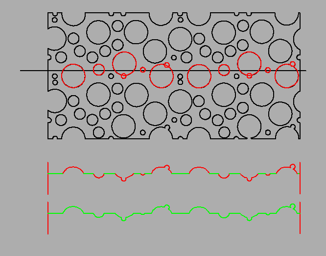

I'm working on a model and am wondering if it is possible to measure the length of a cord/ray in autocad? The geometry is attached below. I'd like to measure the length of a chord from the left to right boundaries, such that at an circle, the chord/ray travels the shortest path around the circle. Please see attached sketch of what i'd like to achieve (please excuse the crappy mouse drawing) as well as the dxf file.

Yes it is possible to measure the chord length simply with a bit of construction.
Draw the chord and then trim all the circles to suit, and then make it all one polyline.
Unfortunately, the circles in your file are not circles! The circles consist of four quarter-circle splines (or parts of). AutoCAD is not too good on splines when it comes to manipulating geometry. So I traced over your 'circles' with proper circles using the 2P option. Then with a bit of trimming, the individual entities are created, which can all be joined together with Pedit.
