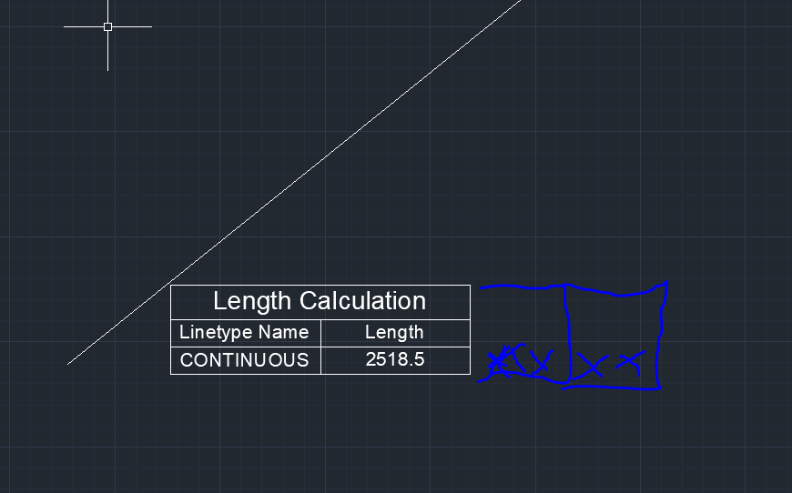

can i have a the total line length of my drawing and multiply by a coefficient for having my line density!?   is it possible!? thanking in advance!?
What application?
In AutoCAD, you could use the ._DataExtraction command and sum up the line lengths and apply a mathematical formula to the total.
Example:
more or less that, i want to add 2 more columns according my multiplicate factor!
Hi Pedro, I hope this can help you, just type "LD" tu run it.
It will give you the length and the density you're looking for.
you can use it for lines and polylines.
It will only be in plain text.

helloIsaac26a and ronjonp, thanks a lot! i am on the my way!

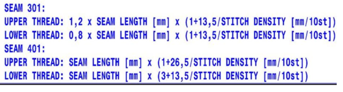

now that i know the stich density i have to return 2 formulas: upper wire and lower wire.
i have to kinds of wire, different stich density, and upper and lower formula for each wire.
