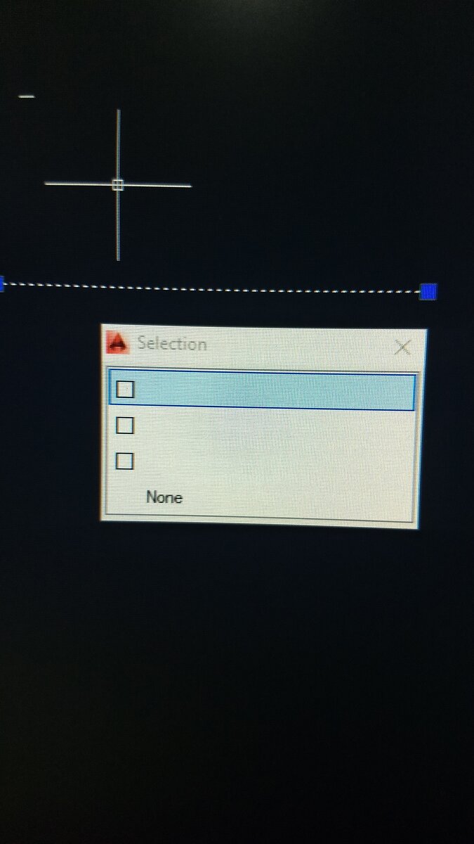

SLW210 Posted February 23, 2021 Posted February 23, 2021 Can you provide more information? What are your computer details? Quote
Nihad Posted February 23, 2021 Author Posted February 23, 2021 Autocad 2014 Pc window 10 pro Intel i3 This happens after uninstalling autocad 360 Quote
SLW210 Posted February 23, 2021 Posted February 23, 2021 As I suspected, AutoCAD 2014 was not made for Windows 10 and similar glitches have turned up. Why did you uninstall AutoCAD 360? Maybe try repairing and/or reinstalling AutoCAD 2014, some shared file could have been removed or damaged, if that doesn't work reinstall AutoCAD 360 and see if that was indeed the problem. What graphics card? Quote
Nihad Posted February 23, 2021 Author Posted February 23, 2021 Intel inbuilt graphics card After reinstall it's ok 1 Quote
