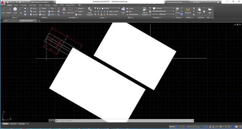

JoeS09 Posted February 21, 2021 Author Posted February 21, 2021 (edited) That certainly did not work. Screen shot attached. This time it drew an inclined rectangle, and it was all white. Never had this problem before. Edited February 21, 2021 by JoeS09 Quote
