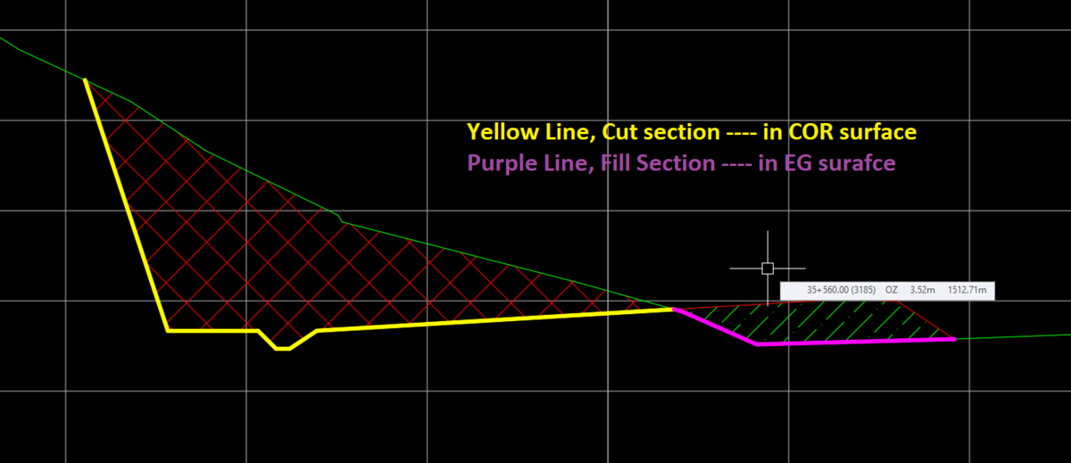

woria2003 Posted February 15, 2021 Share Posted February 15, 2021 Hello To do part of the project, I need to calculate the length of CUT section in civil 3d and Length Of FILL section. like attached Pic. PLZ ---- HELP Quote Link to comment Share on other sites More sharing options...

BIGAL Posted February 17, 2021 Share Posted February 17, 2021 (edited) Dont forget X & Y scale needed.  There was a post about doing volumes automatically I think over at Forums/autodesk may be useful save some brain cells thinking about code.  There is some manual ways copy all xsects block and rescale so 1:1 at true size ie metres etc, there is a break pline at point again I think it was forums/autodesk.  Have to do something now will try later to find very simple 2 pick. Edited February 17, 2021 by BIGAL 1 Quote Link to comment Share on other sites More sharing options...
woria2003 Posted February 17, 2021 Author Share Posted February 17, 2021 @BIGAL Hi , the section is too many , and is not one section . Quote Link to comment Share on other sites More sharing options...
