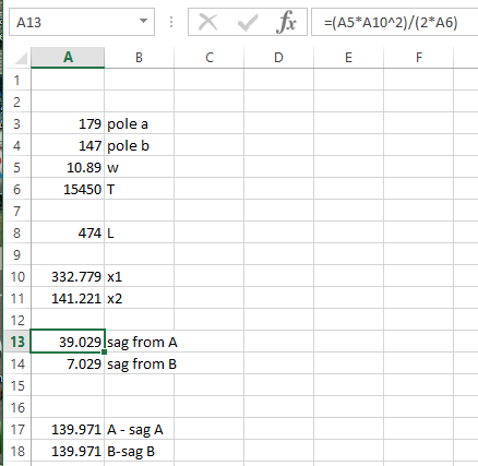

Am I understanding this correctly?
To calculate the sag on this scenario:
Pole A = 179
Pole B = 147
Weight per unit = 10.89
Tension = 15450
If I run this command:
(_maxsag 10.89 (_straightlen (_HeigthDiff 179 147) 474) 15450)

I get 19.8857m sag.
So to my understanding the _straightlen function in combination with _HeightDiff essentially rotates the cable line so that Pole A and Pole B is at the same level.
From there I can use the _maxsag function to determine what the sag is.
Am I correct in assuming that 19.8857 will be my sag with two different size poles?
Thanks for all the help so far!
I created an Excel spreadsheet using the equations in the referenced link and the values from you last post.  x1 and x2 are first determined and then sag1 (from A) and sag2 (from B).  As a check I subtracted the sag from A and compared it to the sag from B.  The bottom point of the cable has an elevation of 139.971m.
Since your input consists of 5 values why not make one function that accepts or prompts for the 5 numbers and then computes x1, x2 sag1 and sag2,  You really only need x1 and sag1 to give you the result.  The other values are just a check.

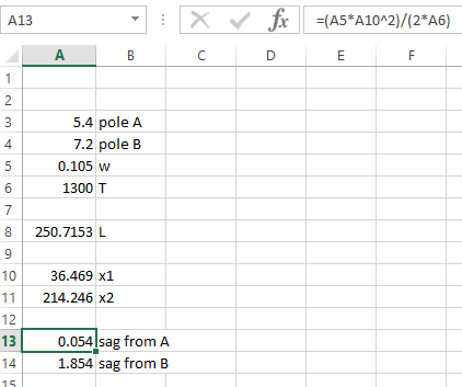

Here is more realistic cable specs:
Pole A = 5.4 (so max sag will be 0.054)
Pole B = 7.2 (so max sag will be 0.072)
Weight per unit = 0.105
Tension = 1300
This has been a great learning curve (pun intended) so far!
To better understand your objective I set up the simple Excel worksheet I referenced in an earlier post.  I assume the goal for the max sag should be applied to the shorter of the two poles as this point will obviously be lower than the sag for the taller pole otherwise there might be zero sag for the shorter pole.  Is that correct?
Using Excel's Goal Seek function and setting a goal of 0.054 for the sag at A it calculates a value for L of 250.7.  Does that seem reasonable?
