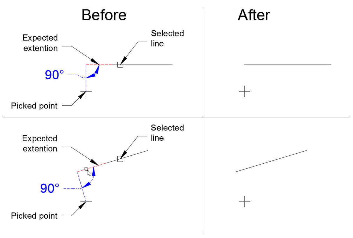

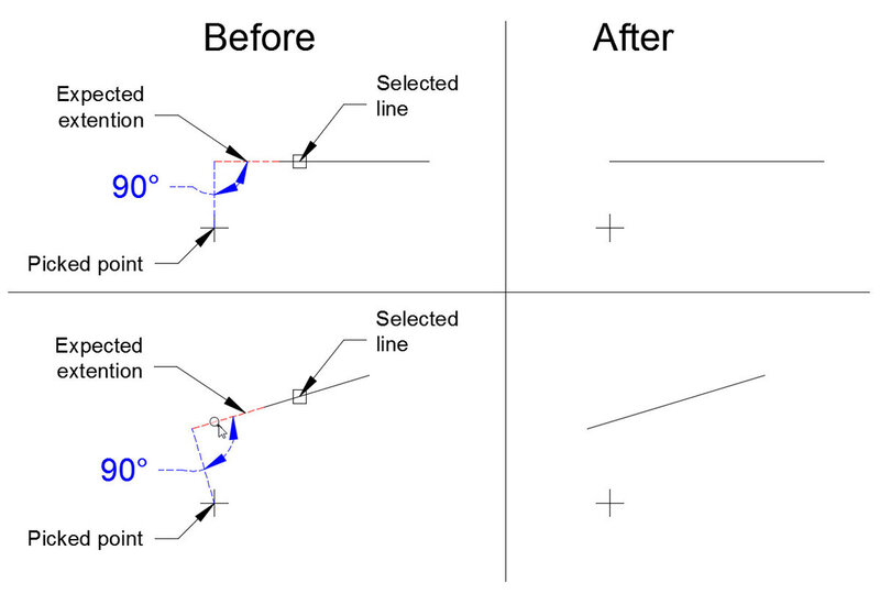

Jozef13 Posted February 10, 2021 Posted February 10, 2021 Dear all, I am looking for a lisp that extend selected line perpendicular to picked point as shown in the picture. Quote
Tharwat Posted February 10, 2021 Posted February 10, 2021 Give this a shot. (defun c:Test (/ s e p a b g x d) ;; Tharwat - 10.Feb.2021 ;; (and (setq s (car (entsel "\nSelect line to extend to desired point : ")) ) (or (= (cdr (assoc 0 (setq e (entget s)))) "LINE") (alert "Invalid object. Please select line object.") ) (or (/= 4 (logand 4 (cdr (assoc 70 (entget (tblobjname "LAYER" (cdr (assoc 8 e))))) ) ) ) (alert (strcat "Select line object resides on a LOACKED layer <!>") ) ) (setq p (getpoint "\nSpecify a point to extend the previously line to : " ) ) (setq a (cdr (assoc 10 e)) b (cdr (assoc 11 e)) g (angle a b) ) (vl-some '(lambda (u) (setq x (inters a b p (polar p (eval u) 1.0) nil)) ) '((+ g (* pi 0.5)) (+ g pi)) ) (setq d (if (< (distance x a) (distance x b)) 10 11 ) ) (entmod (subst (cons d x) (assoc d e) e)) ) (princ) ) 1 Quote
Jozef13 Posted February 10, 2021 Author Posted February 10, 2021 1 hour ago, Tharwat said: Give this a shot. (defun c:Test (/ s e p a b g x d) ;; Tharwat - 10.Feb.2021 ;; (and (setq s (car (entsel "\nSelect line to extend to desired point : ")) ) (or (= (cdr (assoc 0 (setq e (entget s)))) "LINE") (alert "Invalid object. Please select line object.") ) (or (/= 4 (logand 4 (cdr (assoc 70 (entget (tblobjname "LAYER" (cdr (assoc 8 e))))) ) ) ) (alert (strcat "Select line object resides on a LOACKED layer <!>") ) ) (setq p (getpoint "\nSpecify a point to extend the previously line to : " ) ) (setq a (cdr (assoc 10 e)) b (cdr (assoc 11 e)) g (angle a b) ) (vl-some '(lambda (u) (setq x (inters a b p (polar p (eval u) 1.0) nil)) ) '((+ g (* pi 0.5)) (+ g pi)) ) (setq d (if (< (distance x a) (distance x b)) 10 11 ) ) (entmod (subst (cons d x) (assoc d e) e)) ) (princ) ) Thank you very much for your prompt solution. I works perfect in 2D or in the same z-coordinate of both line and point. If I move line in Z-coord. it doesn't work and in my dwg where I want to extend it to circle I obtain alert: "Oblique, non-uniformly scaled objects were ignored." It probably needs to ignore Z-coord of desired point. I enclosed part of my dwg. Extend_2.dwg Quote

Jozef13 Posted February 11, 2021 Author Posted February 11, 2021 I have modified z-coordinate of p-point by z- coord of line point and it works. Both end points of line must have equal z-coordinate. (defun c:ExtL (/ s e p a b g x d) ;; Tharwat - 10.Feb.2021 ;; (and (setq s (car (entsel "\nSelect line to extend to desired point : ")) ) (or (= (cdr (assoc 0 (setq e (entget s)))) "LINE") (alert "Invalid object. Please select line object.") ) (or (/= 4 (logand 4 (cdr (assoc 70 (entget (tblobjname "LAYER" (cdr (assoc 8 e))))) ) ) ) (alert (strcat "Select line object resides on a LOACKED layer <!>") ) ) (setq p (getpoint "\nSpecify a point to extend the previously line to : " ) ) (setq a (cdr (assoc 10 e)) b (cdr (assoc 11 e)) g (angle a b) ) ;;; Redefine z-coord of p-point (setq p (list (car p) (cadr p) (caddr a))) (vl-some '(lambda (u) (setq x (inters a b p (polar p (eval u) 1.0) nil)) ) '((+ g (* pi 0.5)) (+ g pi)) ) (setq d (if (< (distance x a) (distance x b)) 10 11 ) ) (entmod (subst (cons d x) (assoc d e) e)) ) (princ) ) Quote

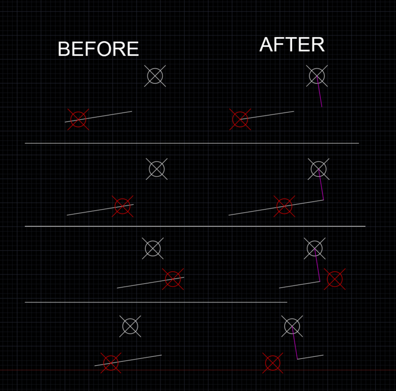

Guest Posted May 3, 2022 Posted May 3, 2022 Hi lrm nice update but i find a problem with the trim. Trims the line from the side nearest to the point. Is it possible to trim from the selected side of the line? Thanks Quote

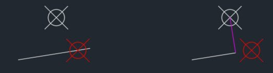

lrm Posted May 4, 2022 Posted May 4, 2022 (edited) The program functions as you requested in your first post. The following is how I interpret your revised request. Do you really want to trim the far end from the projected point if that is where the line is picked. The red points are where the line was picked. The whit points are the point to set the trimming. The magenta line indicates the projected point onto the line. Please edit the drawing/image to define what you want for these 4 cases. trim lines.dwg Edited May 4, 2022 by lrm Quote

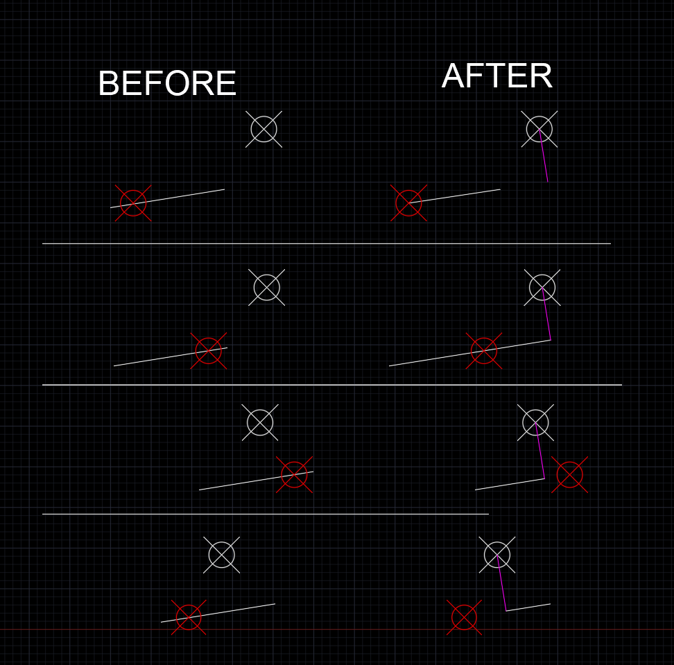

Jozef13 Posted May 4, 2022 Author Posted May 4, 2022 Hi, my expectations for those 4 cases are following trim lines.dwg Quote

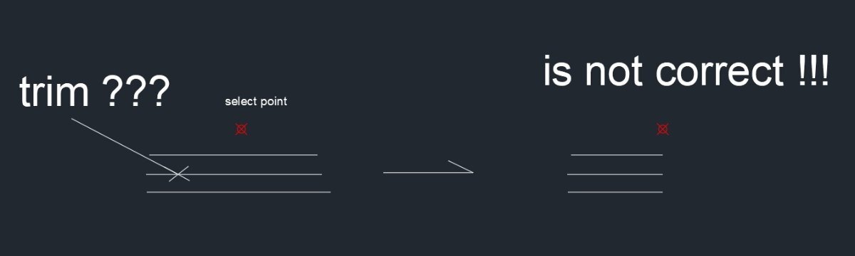

Guest Posted May 4, 2022 Posted May 4, 2022 Hi lrm. Look the example. Is not trim in correct direction. Trim. The extend is correct because the extend point is far away from the line, but when I trim the line is more complicated Drawing1.dwg Quote

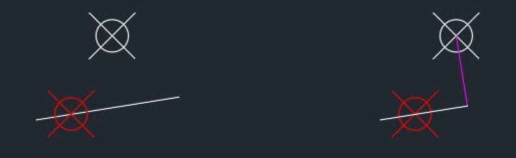

lrm Posted May 4, 2022 Posted May 4, 2022 It's still not clear what you want. From your post implies that the line should be trimmed for the segment where the line is picked (selected). Whereas (again from your post), the following implies the opposite. That the pick point identifies the portion of the line to keep. Which is it. Keep or delete the segment with the pick point? AutoCAD's trim command deletes the segment containing the pick point. Quote

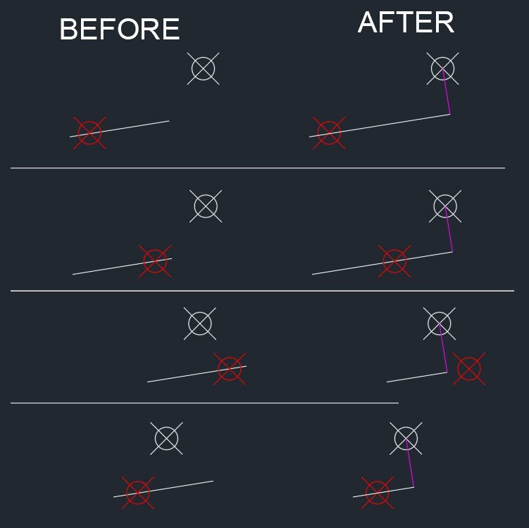

lrm Posted May 4, 2022 Posted May 4, 2022 This version trims the portion of the line where the line is picked for selection. I ; Trims selected line to the 3D projection of a point to the line. ; The line selection pick determines segment to be trimmed. ; L. Minardi 5/4/2022 (defun c:test (/ p ss en ed e1 e2 ea eb end u d ee) (setq p (getpoint "\nSpecify projection point.")) (setq more T) (while more (setq ent (entsel)) (if ent (progn (setq pp (cadr ent) en (car ent) ed (entget en) e1 (cdr (assoc 10 ed)) e2 (cdr (assoc 11 ed)) ) (if (> (distance e1 p) (distance e2 p)) (progn (setq ea e1 eb e2 end 11 ) ) (progn (Setq ea e2 eb e1 end 10 ) ) ) (setq u (uvec ea eb) d (dot (mapcar '- p ea) u) ee (mapcar '+ ea (mapcar '* u (list d d d))) ; project point ) ; is ee in line segment (if (< (* (dot (mapcar '- ee ea) (mapcar '- ee eb))) 0.0) ;case for ee in line segment (progn (if (> (* (dot (mapcar '- e1 ee) (mapcar '- pp ee))) 0.0) (progn (setq end 10) (entmod (subst (cons end ee) (assoc end ed) ed)) ) (progn (setq end 11) (entmod (subst (cons end ee) (assoc end ed) ed)) ) ) ) ; case for ee beyond line segment (entmod (subst (cons end ee) (assoc end ed) ed)) ) ; end IF line segment check ) (setq more nil) ) ; end IF ent ) ; end while (princ) ) ; calculate unit vector from v1 to v2 (defun uvec (v1 v2 / s) (setq s (distance v1 v2)) (setq s (mapcar '/ (mapcar '- v2 v1) (list s s s))) ) ;;; Compute the dot product of 2 vectors a and b (defun dot (a b / dd) (setq dd (mapcar '* a b)) (setq dd (+ (nth 0 dd) (nth 1 dd) (nth 2 dd))) ) ;end of dot Quote
Guest Posted May 4, 2022 Posted May 4, 2022 The second code does exactly what I want. If it gives me the opportunity (like the previous code) to select window, more than one lines will be perfect. Quote
