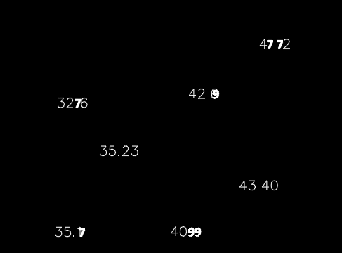

Steven P Posted February 5, 2021 Author Posted February 5, 2021 (edited) Good morning, Here is an area from the drawing I was talking about this week, wonder if this will work Stefan PDF to Text Example.dwg Edited February 5, 2021 by Steven P Quote

Stefan BMR Posted February 6, 2021 Posted February 6, 2021 21 hours ago, Steven P said: Good morning, Here is an area from the drawing I was talking about this week, wonder if this will work Stefan Hi My method works with ttf only, based on the area and the perimeter of the outer boundary. Unfortunately, this doesn't work in your situation. I think it is possible, with my lisp and some extra steps, or some other methods, but now I don't have the time. Sorry. 1 Quote
