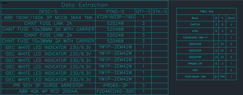

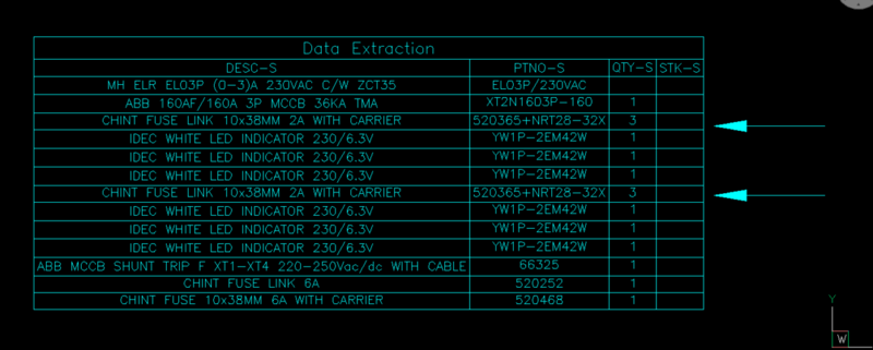

Ak23 Posted February 3, 2021 Posted February 3, 2021 Hi , I want to merge duplicate names and at the same time , Qty-s also want to add. Any Lisp Code Quote
BIGAL Posted February 3, 2021 Posted February 3, 2021 (edited) Yes it starts with block with attributes and produces a table , it sorts on up to 5 attributes deep, can you post a sample dwg ? So can test. The DEC White would be 1 line with total. Its not free but very cheap. Edited February 3, 2021 by BIGAL Quote

BIGAL Posted March 19, 2021 Posted March 19, 2021 Your dwg has had a lot of editing to the table not saying it could not be done with look ups a lot more work, but over at forums\autodesk just did find text values in table and change, this is what is directly dumped just select blocks. Took like 5 seconds to do. Stuff like change headings is easy. So "INDICATOR" is IDEC WHITE LED INDICATOR 230/6.3V Happy to discuss a fee beer is cheap. Quote
