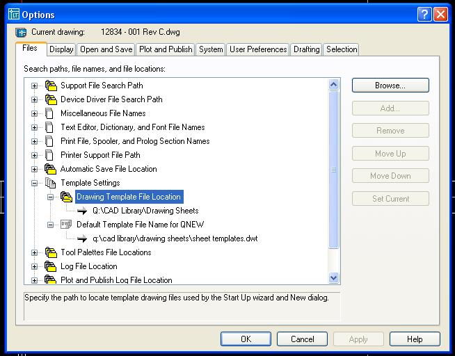

stevsmith Posted February 9, 2009 Posted February 9, 2009 Why dont you set it up to open your own default dwt template? We have a template to suit or needs that is customised withlayers, line types, dim settings. When AutoCAD opens it autoatically opens this file so we are raring to go. Quote

bonehead411 Posted February 26, 2009 Posted February 26, 2009 You need to create a template file (if you haven't already) and point ACAD to it in the options menu. Quote
