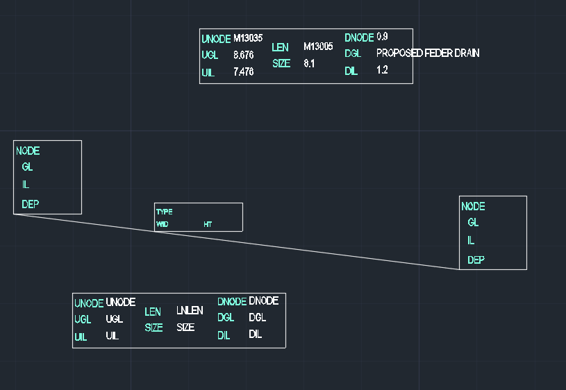

Good day everyone,
 I like to merge three blocks attributes to one block with attributes. I'm not good at VBA. I hope someone correct the below code for me. Thanks

Here the code revised:
You have to assign the Attribute Value stored into the Textstring Array property into a Variable and then assign the newblock attribute value as the variable.

@PeterPan9720 நன்றிகள் பல Thank you so much bro. It worked.
