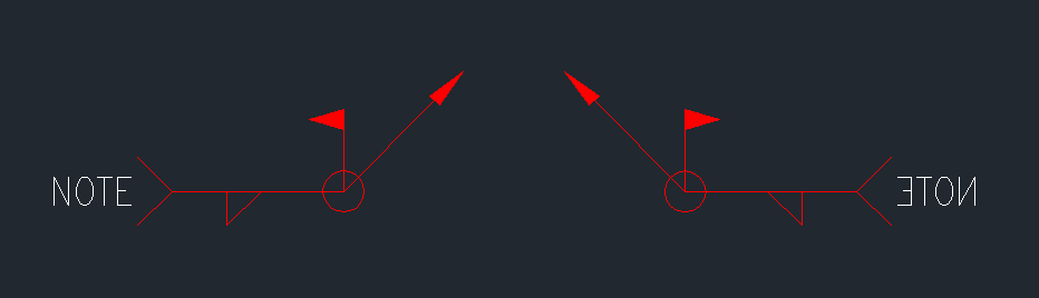

I'm working on a dynamic block for weld symbols.
There is a Flip action which causes and issue with Text.
What is the simplest way to fix.
Trying to keep it simple as there are a few Parameters and Actions and it's getting crowded with all the annotation in there.
I haven't attached the DWG as it's still in progress.
If you change your text style to annotative there  is then the tick-box that will keep text always facing the right way.
