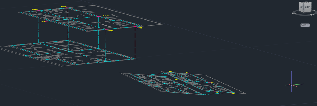

Elektrik Posted January 28, 2021 Posted January 28, 2021 I try to use flatshot comment in this file, and get an error saying "There are no solids or surfaces that can be projected.". Do anybody know why I am getting this message and how I could fix the problem? Thanks in advance. Earthing.dwg Quote
SLW210 Posted January 28, 2021 Posted January 28, 2021 There are no solids or surfaces, what is flatshot supposed to do? Quote FLATSHOT (Command) Creates a 2D representation of all 3D objects based on the current view. Quote
Cad64 Posted January 29, 2021 Posted January 29, 2021 21 hours ago, Elektrik said: I try to use flatshot comment in this file, and get an error saying "There are no solids or surfaces that can be projected.". Do anybody know why I am getting this message and how I could fix the problem? Thanks in advance. What are you trying to do? Quote
Elektrik Posted January 29, 2021 Author Posted January 29, 2021 5 hours ago, Cad64 said: What are you trying to do? I was trying to flatten a 3d drawing to a 2d drawing, and I did it with some other comment. 1 Quote
SLW210 Posted February 1, 2021 Posted February 1, 2021 The drawing you posted has 0 3D objects. FLATSHOT works on 3D objects. What you posted was a 2D drawing with some components having a Z value. Lots of info on making those types of drawings have Z=0. 1 Quote
