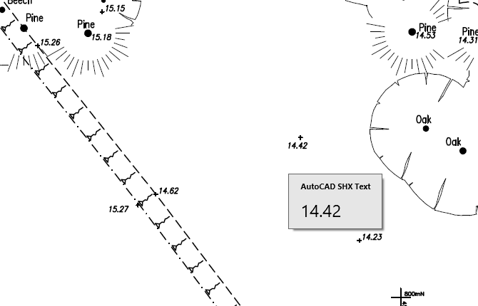

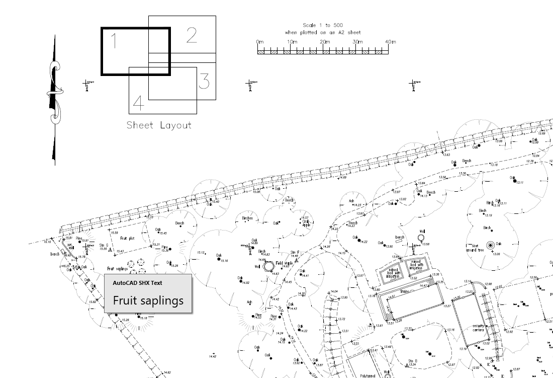

eldon Posted January 20, 2021 Posted January 20, 2021 I am not quite sure why you are not able to select RomanS shx font in a PDF file. I have an old survey where all the text was in RomanS shx font. I used DWG TrueView to turn it into a PDF, and all the text was recognized. I use Acrobat Reader DC. So I am not sure whether your problem is widely shared. 1 Quote
sketch11 Posted January 20, 2021 Author Posted January 20, 2021 (edited) That's interesting. I think others have the same issue as I did read about it before posting. The width factor change as well is another reason. Edited January 20, 2021 by sketch11 Quote
eldon Posted January 20, 2021 Posted January 20, 2021 All the ground spot levels have a width factor of 0.85 and an obliquing angle of 12, and they are all recognized as SHX text. Quote
SLW210 Posted January 20, 2021 Posted January 20, 2021 I believe it was AutoCAD 2016 that first had the searchable/selectable SHX font capabilities in a PDF (and Dwg TrueView as well). Quote
