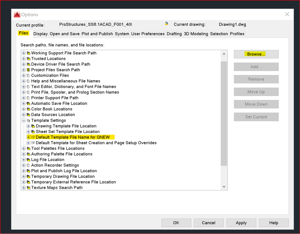

Just go to OPTIONS and follow the screenshot.  Browse to the Template list and select one ending in ISO, to ensure Metric units are the default.
Be sure to confirm your new selection by hitting OK, before closing the dialog.  ;)

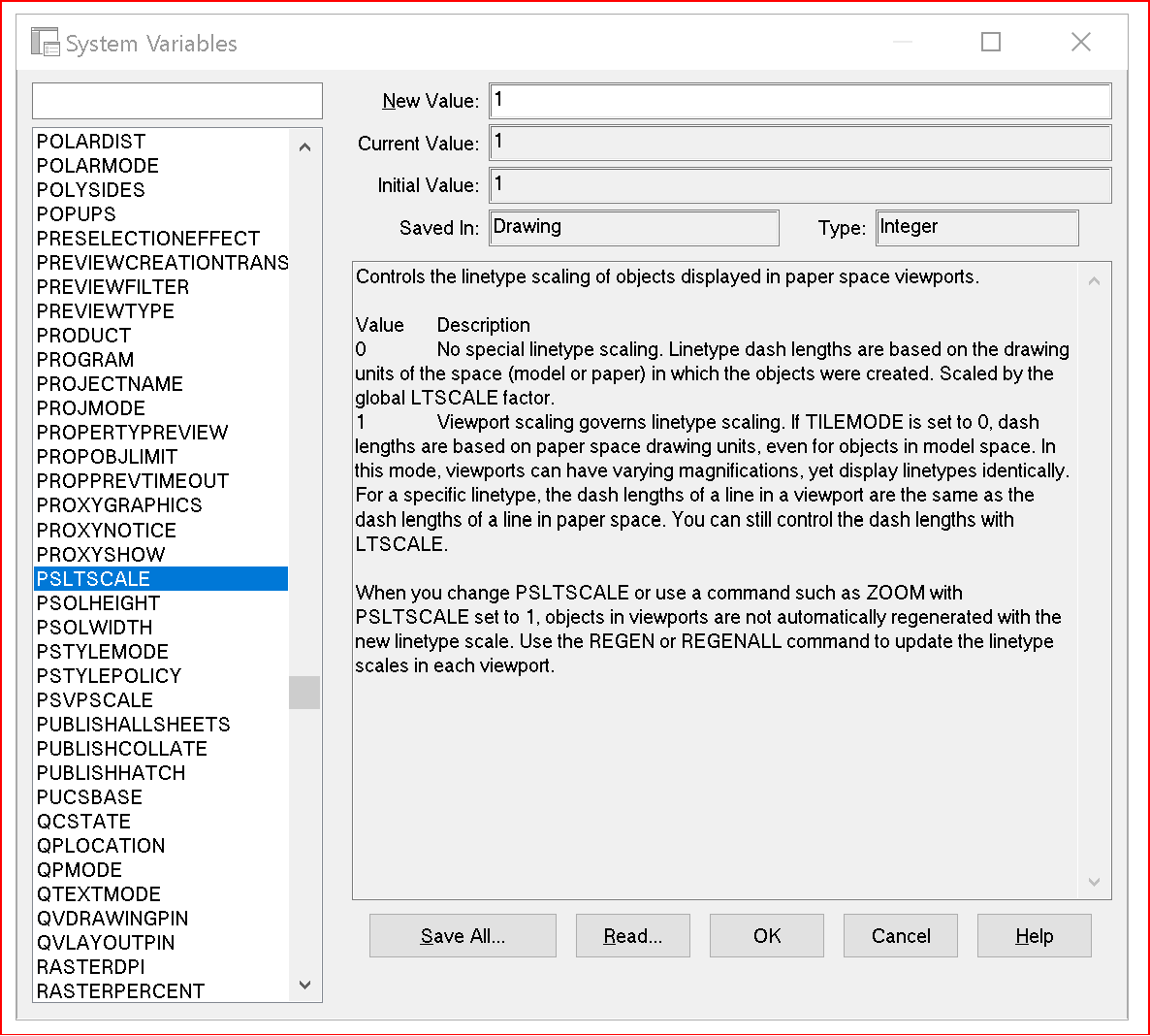

If you open your SYSVDLG window, as shown in the screenshot,
perhaps you can find the variable which you are searching for.
Or perhaps this PSLTSCALE will shed some light?

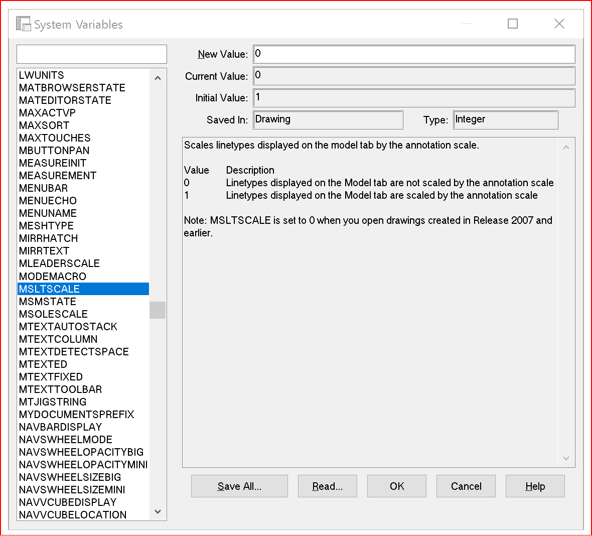

Or the second one for MSLTSCALE?
