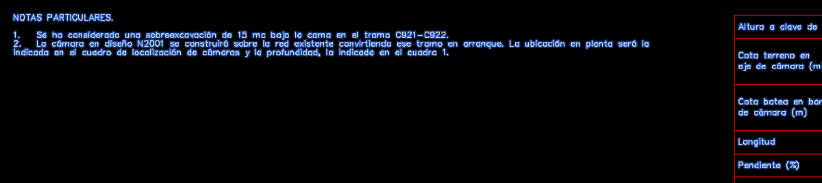

JovanG Posted January 26, 2021 Author Share Posted January 26, 2021 On 1/15/2021 at 1:36 PM, Lee Mac said: You can achieve this using the wildcard not operator ("~") : Hello guys. I have been using this program without any problem at all, but today it doesn`t work well as shown in the image: It select all text including the Mtext with "~*NOTAS PARTICULARES*" condition. I attach the showed file hoping you can see why is not working in this case. I really thank you for your help P-459_50_PR.dwg Quote Link to comment Share on other sites More sharing options...
pkenewell Posted January 26, 2021 Share Posted January 26, 2021 @JovanG In long MTEXT strings like this, you also have to filter for the DXF code 3, not just DXF code 1. Note - This is what your entity codes look like for the MTEXT: ((-1 . <Entity name: 1cf6aa46180>) (0 . "MTEXT") (330 . <Entity name: 1cf57559700>) (5 . "3610") (100 . "AcDbEntity") (67 . 0) (410 . "Model") (8 . "Textos") (62 . 7) (6 . "Continuous") (370 . 13) (100 . "AcDbMText") (10 835795.0 1.19418e+06 0.0) (40 . 1.0) (41 . 114.291) (46 . 8.27327) (71 . 1) (72 . 5) (3 . "{\\Fdgn000|c0;NOTAS PARTICULARES.\\P\\P1.\tSe ha considerado una sobreexcavación de 15 mc bajo la cama en el tramo C921-C922. \\P2.\tLa cámara en diseño N2001 se construirá sobre la red existente convirtiendo ese tramo en arranque. La ubicación en planta se") (1 . "rá la indicada en el cuadro de localización de cámaras y la profundidad, la indicada en el cuadro 1.}") (7 . "Style-Arial") (210 0.0 0.0 1.0) (11 1.0 2.88641e-12 0.0) (42 . 109.571) (43 . 7.35743) (50 . 2.88641e-12) (73 . 2) (44 . 0.903614)) Notice the test string has a 3 in the dotted pair instead of a 1. Try this now: (sssetfirst nil (ssget "_X" (list '(0 . "TEXT,MTEXT") '(1 . "~*NOTAS PARTICULARES*") '(3 . "~*NOTAS PARTICULARES*") (cons 410 (getvar 'ctab))))) 1 Quote Link to comment Share on other sites More sharing options...

Lee Mac Posted January 27, 2021 Share Posted January 27, 2021 Filtering on DXF group 3 is problematic in general, given that there are potentially multiple occurrences of this group within the DXF data - even a simple ssget filter such as the following will be unsuccessful: (ssget "_X" '((0 . "MTEXT") (3 . "*NOTAS PARTICULARES*"))) However, since each DXF group 3 entry will contain a 250 character portion of the MText content, there is a chance that the target pattern will be spread between the values held by two of such groups, and therefore could not be matched by any ssget filter list of the above form. There is also the possibility that the target text wil be interspersed with MText formatting codes, which will also cause this selection method to fail. The most reliable solution would be to acquire a selection set of all MText objects within the current layout/viewport, iterate over the set and, for each entity, construct a string representing the entire MText content (from all DXF group 3 entries and the DXF group 1 entry), remove all MText formatting codes from the string, and then use the wcmatch function or vl-string-search function to test whether the target string is present, removing or retaining the entity from the selection set as required. Quote Link to comment Share on other sites More sharing options...
