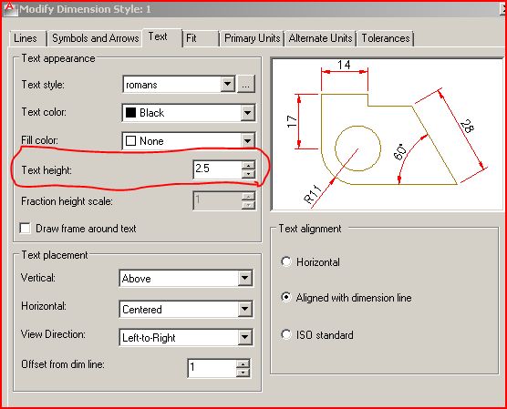

Dadgad Posted July 8, 2012 Posted July 8, 2012 Perhaps this will help you, these are some of the DIMSTYLE dialog pages on which you create a new dimstyle. The blue line in the image is the edge of a viewport which I have set to display at 1:8, and locked, so that value is set. I have then created a new dimstyle by copying an existing dimstyle, and giving it a new name. The name I have given it is "8" , being the reciprocal of the scale 1/8. On the primary units tab I have set the SCALE FACTOR for this dim style as "8". As I do my dimensioning in paperspace this is an appropriate dimstyle to use on a drawing which is being displayed in a viewport of 1:8. Now I can just turn on my OSNAPS and get to work. I hope this helps you a bit, come to grips with using paperspace, viewports and dimstyles. Quote
