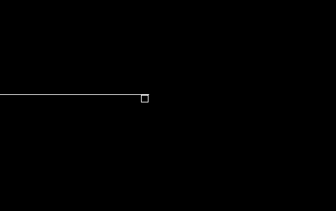

I made a short function that extends a line with an arc tangent to the line you selected.
The function works exactly the same as continuing a polyline only lets you select an object to start with.
Anyway, I decided to share it, so here it is:

Nice routine! Thanks for sharing. Saves some steps from my normal method to draw as pline > straight > then arc segment.
made the attached animation using https://www.screentogif.com/
Thanks Dan. I tried the screentogif program, works pretty well.

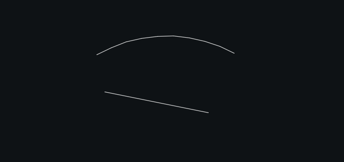

Here is another gif which shows it also works on an arc. 😁
I like it, and its useful for me!
