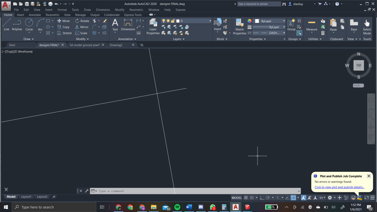

Hi all,

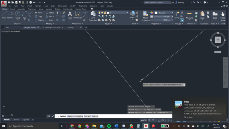

My cad model when exported to sketchup i realised some of the lines weren't intersecting and when i went to the CAD file and zoomed in tried to extend the line it didn't want to and from the other side the line is overlapping the parpendicular line
Are the lines, or their endpoints, at different 'Z' values?

Nukecad drew a line 0,0,0  0,0,10 drew another all at Z = 0 Extend worked and trim worked,  pretty sure I have used this to get a Z value of a line at a x,y point.
