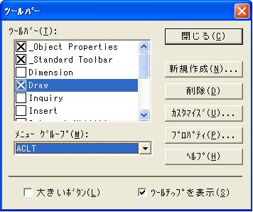

Thanks for the reply. Have attached a screen shot of what i get when i do a right click on the button. Its all in Japanese...(I too dont understand the whole lot except for a few) Hope someone must be knowing atleast the shortcuts and be able to help me on this... Am totally clueless!! :unsure:
