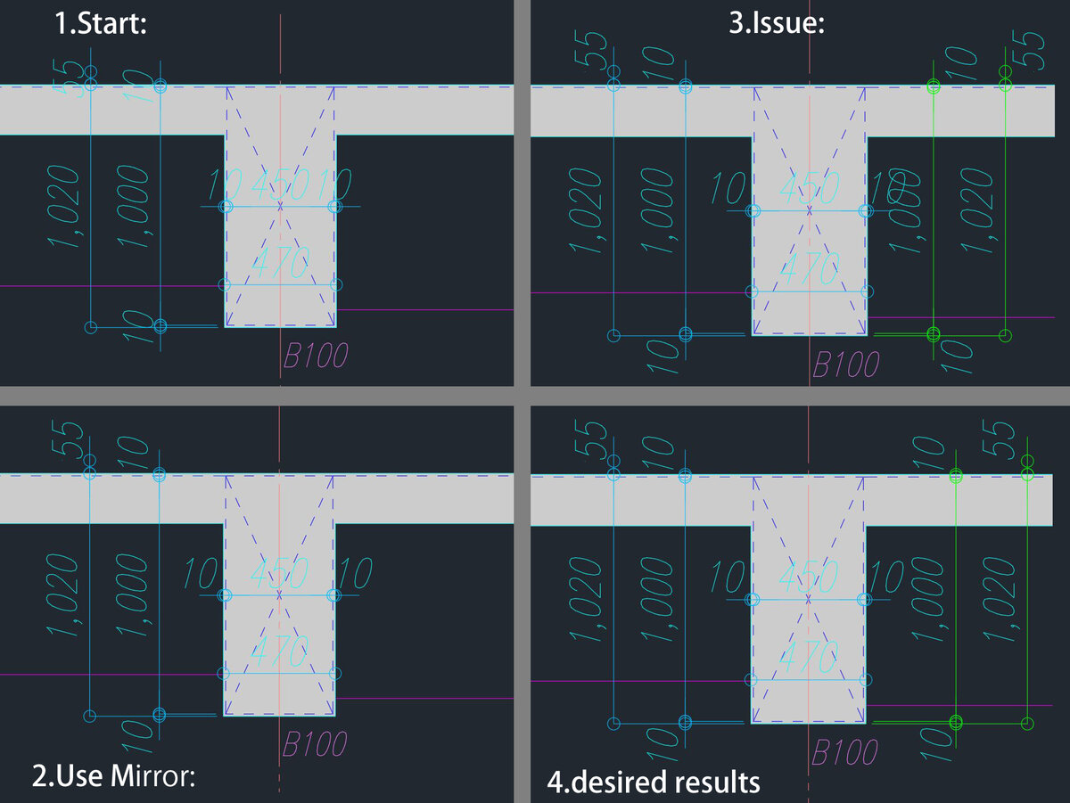

I have 2 problems: Extend line and Dimension text.
1.Extend line: [IMG1]
-I use the attached Lisp to "trim" ext Lines. (select the parallel and linear dimensions. And specify the position of the line pins) No2-IMG1.
-The Cons of this lisp. when specifying the line foot at the dimension line. then re-command will cause the dimesion jump. No3-IMG1.
>>> I want to select all dimensions (Rotated and Align dim ..) and change the length of the Ext lines to 0 or very small. So that it does not overlap with other lines. Then possible for change extline again . No4-IMG1.
>>> It is possible to change the Ext line length after setting length = 0. And it is possible to change the  extline for all or one by one.

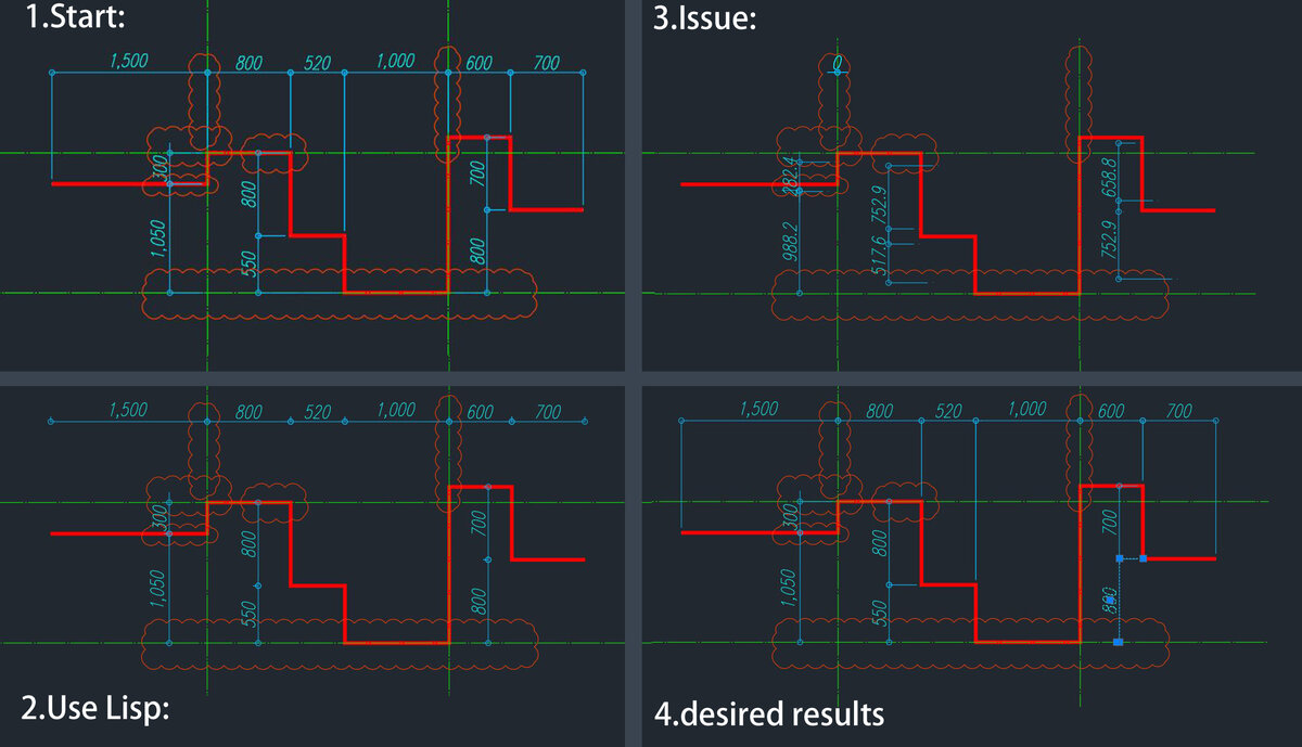

2. Dimension Text: [IMG2]
- For small distances. Dimension will overlap with other lines. I made a manual move to drag it to the sides (Left, Right). No2-IMG2.
-When mirroring these dimensions. It will be below the dim line. I have to move it manually or use the command "Ai_Above_DimLine" one by one and cannot be used for multiple dimensions at the same time. No3-IMG2.
>>> Is there any solution to choose the position (Left, Right, Mid, Top, Bot ...) like justify of text compared to the Ext lines. And can Adjustment offset position (with arrow button for example)
>>> It is possible  command "Ai_Above_DimLine" for all dim or selection.
